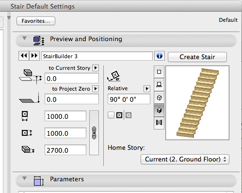

Not familiar with the 4D Library objects, but do they show in the preview window in 3D?
nope, so there is something wrong with the symbol itself I guess, I have contacted the creator.
