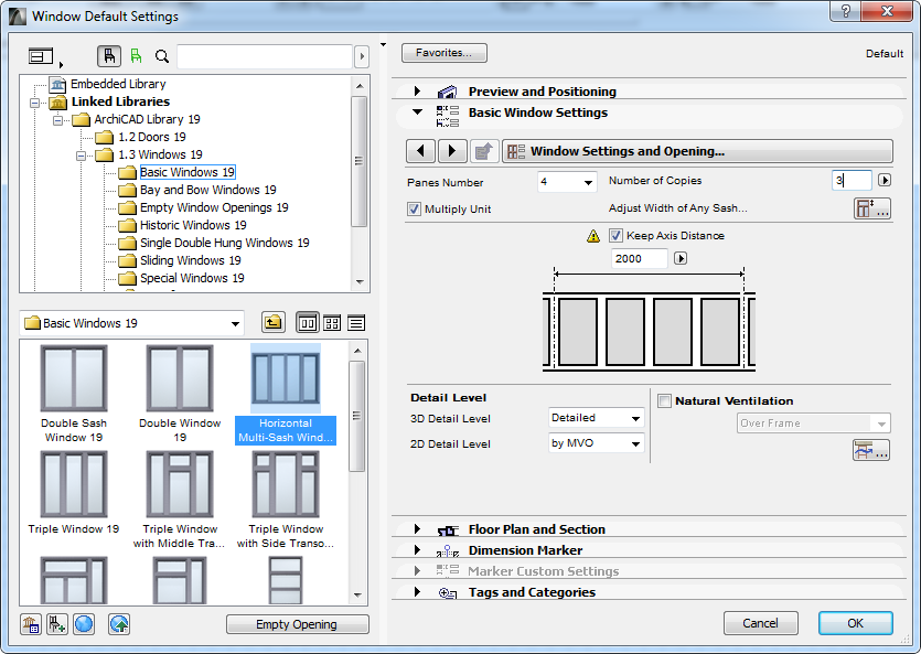

There is a Window called "Horizontal Multi-Sash Window 19", where you can specify the pane number, and also it has a "Multiply Units" checkbox, which you can check and then specify the number of units.
There is also a "Vertical Multi-Sash Window 19", which works the same way, only in the vertical direction.

Interesting! On those windows, which settings panel has the option for the number of units? (wall opening, connecting structures, etc.)

The Window Settings and Opening page of the object.
See attached image.
adamsb
Ah, interesting again! Thanks Lazlo, that helps to know, but no option like that exists on my Window Settings and Opening page.
Is there a way to make sure that this option gets added to these objects on an upcoming Update?

The best would be for you to make a wish for either these options to get added or for the Window object to be included in the US library as well.
Or, you could download the INT version from myarchicad.com, extract its Library Container File and use the objects from there.
