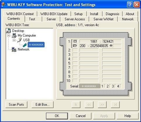

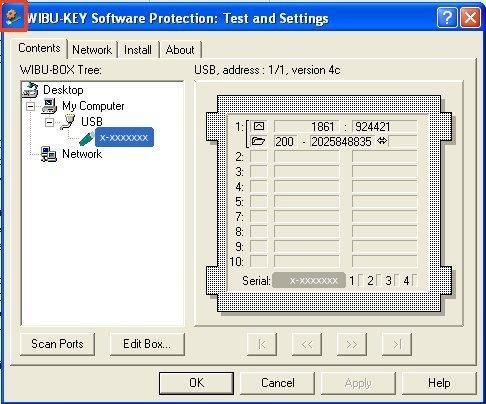

The WIBU-KEY Control Panel (PC)
The main WibuKey management instrument on PC is the WIBU-KEY Control Panelwhich is accessible from the Windows Control panel.
This control panel has a so called "Advanced View". It can be activated in the system menu or by clicking onto the WIBU-KEY ICON title bar. (red rectangle)
Functions of the WibuKey control panel:
  • Contents : displays WIBU-BOXes connected locally or to a WkLAN server.
  • Test : basic connectivity test for local WIBU-BOXes.
  • Server : configure WIBU-KEY server options.
  • Server Access : configure client access permissions. Here is where you can set who can access the licenses on a NET key
  • Server WkNet : configure WkNet server options.
  • Network : client network settings. Here is where you can define the address of a WibuKey Server
  • WIBU-BOX Context : save WIBU-BOX content to a file (Remote Programming Context File).
  • WIBU-BOX Update : update WIBU-BOX from Remote Programming Update File.
  • Setup : interface and driver configuration.
  • Install : install, uninstall or update WIBU-KEY drivers Diagnosis Display driver diagnosis messages.
  • About : software information.

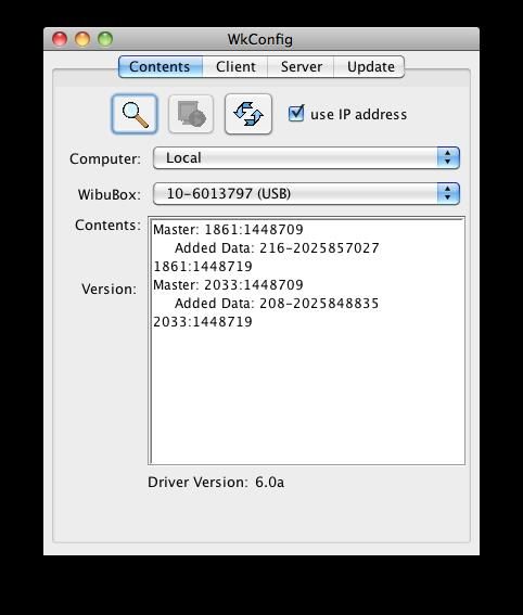

The WkConfig application (Mac)
The WkConfig .app is the Mac counterpart of the WibuKey Control panel. It is located in the Applications/WIBUKEY folder
  • wp-content_uploads_archicadwiki_wibukey-aboutwibukey--wkconfigcontents.jpg
Functions of WkConfig :
  • Contents: Shows the codes of the programmed key content - if no data appears on this page, then the computer does not recognize the key at all.
  • Client: Enables/disables and orders the Subsystems: 'Local' enables/disables the use of a key attached to the local computer, and WkLAN does the same for a NET key on a different computer. You can change the search order of subsystems - should ARCHICAD look for a local or a network key first. If WkLAN is enabled, you can also define the address of the WibuKey Server. (see details at WibuKey/Server)
  • Server: Basic Server settings (see details at WibuKey/Server)
  • Update: Lets you create and load a "remote Context Files" (not used by Graphisoft)
