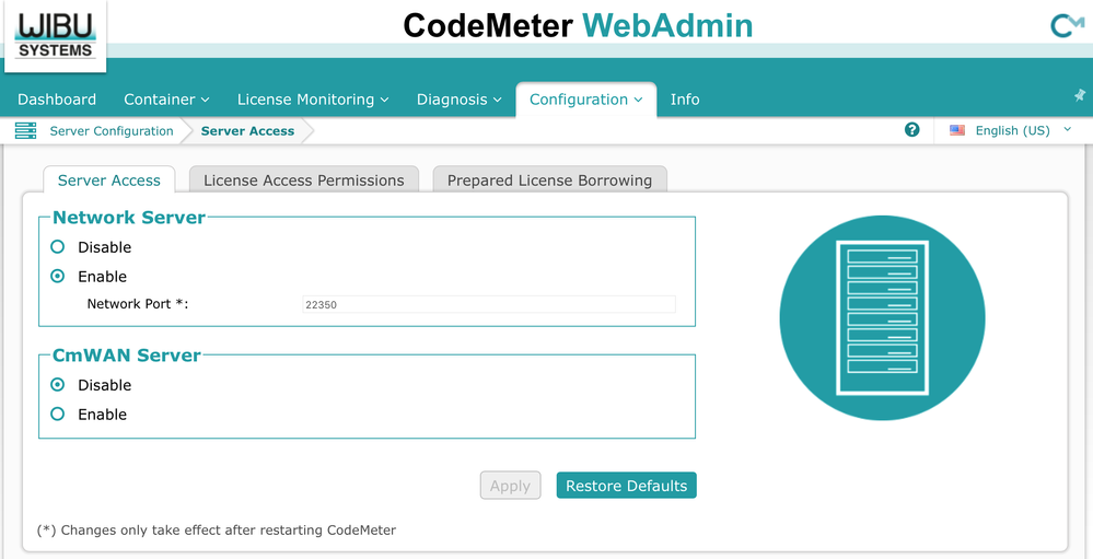

Server side
CodeMeter settings
  • Open CodeMeter Webadmin (right click on CodeMeter icon on tray/run CodeMeter application and click on WebAdmin)
  • Define the network port on configuration/network tab - by default it is 22350
  • Check 'Run Network Server' checkbox - without that the server will be only accessible from the local network (LAN)
  • Apply
  • Restart CodeMeter service in CodeMeter Control Center on Windows and in System Preferences/CodeMeter on OSX.
Here is an example screenshot of a server's settings:
Network settings
  • Make sure that the defined port is open on the server's firewall in both directions
  • If the server is behind a router or a gateway the port needs to be forwarded (In Wibu article you can read about how to set NAT/port forwarding: Using Wibu key Over the Internet)

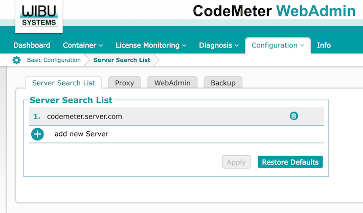

Client side
CodeMeter settings
  • Define the network port - the same as on the server
  • Add the server's public IP address to the Server Search List
  • Apply
Here is an example screenshot of a client's settings:
Network settings
  • Make sure that the defined port is open on the client's firewall in both directions
  • If the client is behind a router or a gateway the port needs to be forwarded (In Wibu article you can read about how to set NAT/port forwarding: Using Wibu key Over the Internet)
