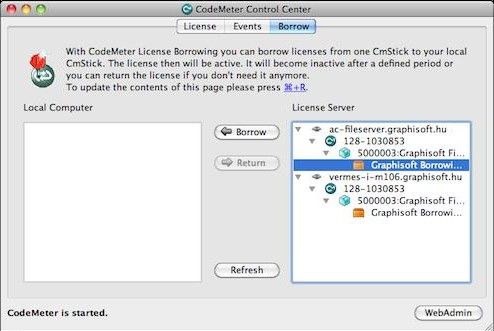

A free license is needed for the borrow operation
UPDATE: In ARCHICAD 15 this has been fixed. (Make sure you have only one ARCHICAD session running on the computer where you would like to borrow a license.) For the borrow operation one free license is needed. If you haven't got a free license close your ARCHICAD on the computer where you would like to borrow a license (then this license will be free) and borrow from the CodeMeter Control Center.
  • run CodeMeter Control Center from Applications/using the Start menu
  • choose the Borrow tab
  • select the license and borrow
  • the return can be done from here as well

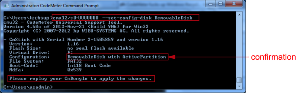

The computer does not start when a CodeMeter key is plugged in
This problem only occurs occasionally on Windows operating systems. The computer recognizes the CodeMeter key as an USB storage drive and tries to boot from that. Here is how you fix it:
  • Search for CodeMeter Command Prompt and double-click to run it.
  • A command window will appear.
  • Type the following & press Enter or Return:   cmu32/sx-xxxxxxx --set-config-disk RemovableDisk
Where x-xxxxxxx is the serial number printed on the USB key starting with the first number digit after "SN:" Make sure you include a space after x-xxxxxxx and disk Example:
  • As it prompts in the command window, unplug and re-plug the CodeMeter key back in.
  • Finish.

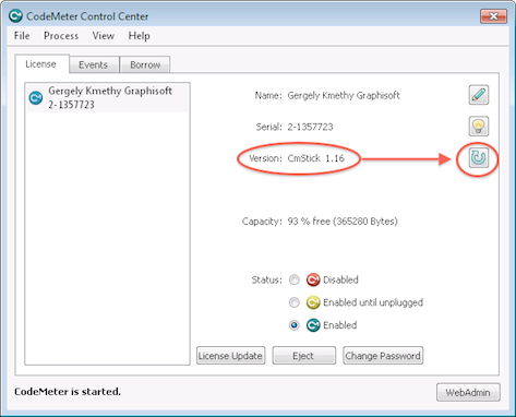

To Reset to Default: Repeat the above using the command below instead: cmu32/s0-0000000 --set-config-disk LocalDisk If your key's Firmware version is lower than 1.16, then:
  • Open CodeMeter Control Center from All Programs/CodeMeter/CodeMerter Control Center
  • Click on your key
  • Check the version, and if it is lower than 1.16 then click the icon near that to update the firmware

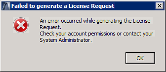

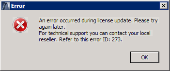

Nothing happens when clicking on connect - first time borrowing
In case you are about to borrow the first license, ARCHICAD tries to connect to the GRAPHISOFT server. (CodeMeter/LicenseBorrowing#InactiveLicense) There are cases where it fails - get you simply back to the previous dialog. In that case:
  • try to borrow again and use the offline way - generate request (as described here.)
  • try to import back the result file
  • if it also fails open CodeMeter Control Center
  • select the license visible there on the list (not starting with 2 or 128)
  • click on license update and use the file you downloaded from the GRAPHISOFT site

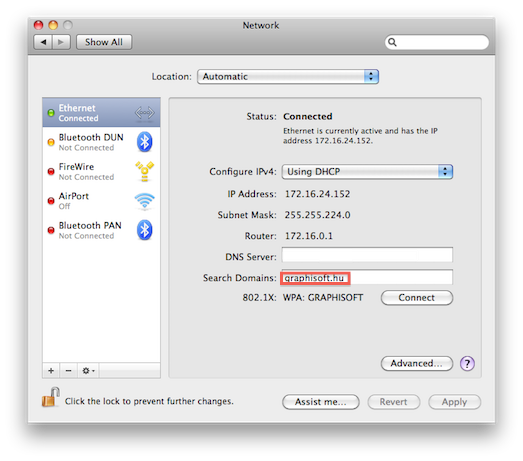

The system administrator might help how to make possible to reach the server using that name. In many cases it is worth it to change how the server is identified by the clients. By default this is based on the server's hostname, but in many cases the clients cannot reach the server on the name as it nows about itself. (Networks without a DNS server, mixed environment - Macs+PCs). Here you can find how to change this on the server side: CodeMeter/LicenseBorrowing#How_to_set_up_a_CodeMeter_license_server Only the computer name identifies the server Sometimes the value contains only the computer's name (computer) and not the full domain name. (computer.domain.com) In the network settings it can be made possible to reach the server.
  • on Mac: Open System Preferences, Network, select the used connection type, enter the domain in the Search Domains field (domain.com)
