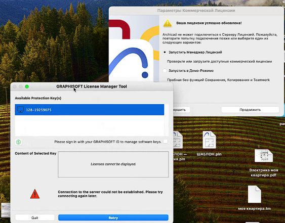

I Do have a correct serial number. Archicad doesn't give me the correct panel where I can enter it, it only gives me to run in demo mode, or to run the license manager. Please, look at attachment {B2BE3CC8-CB9D-4A20-BA46-5F342EA754A6}.png
Eduardo Rolon
Only thing I can think of is that EDU is not an option in your location.
Based on the screenshot you are using RUS version so that might be it.
Send an email to the one listed in the article.
