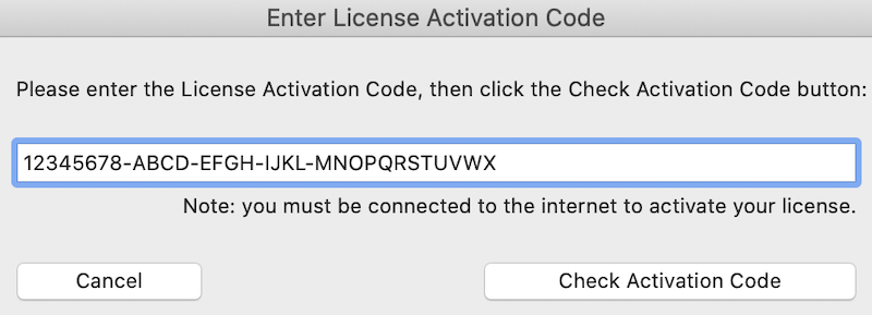

Archicad 23 and newer
  • Upon Archicad launch, a window pops up to inform you that no Archicad license was found.
  • Choose the option to activate Archicad with “Emergency license code
  • Enter the License Activation Code you received from your Distributor

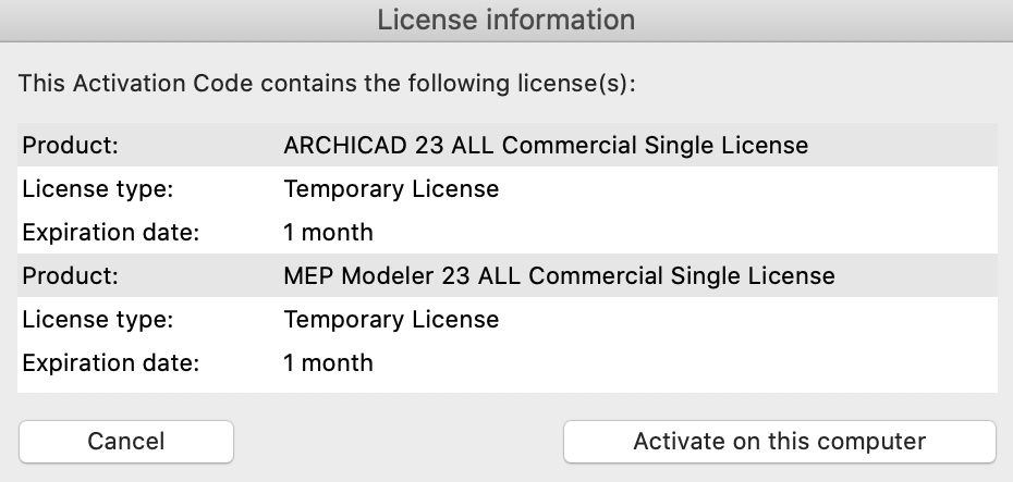

  • Press “Check Activation Code
  • This will send the activation request to Graphisoft’s servers to validate the Emergency license.
  • If the validation is successful, the License information window shows what type of License you obtained and when it will expire.
  • Simply click on “Activate on this computer” to continue

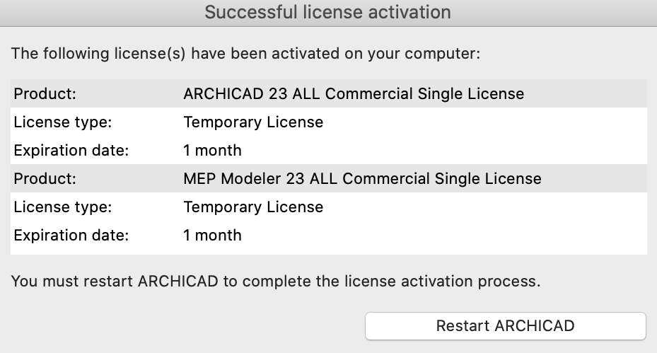

  • The process of downloading and activating the license will start.
  • Please allow a handful of seconds for the operation to be completed.
  • You’ll see a Successful license activation window
  • Restart Archicad to run it in fully licensed mode.

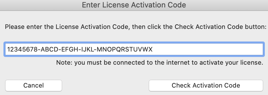

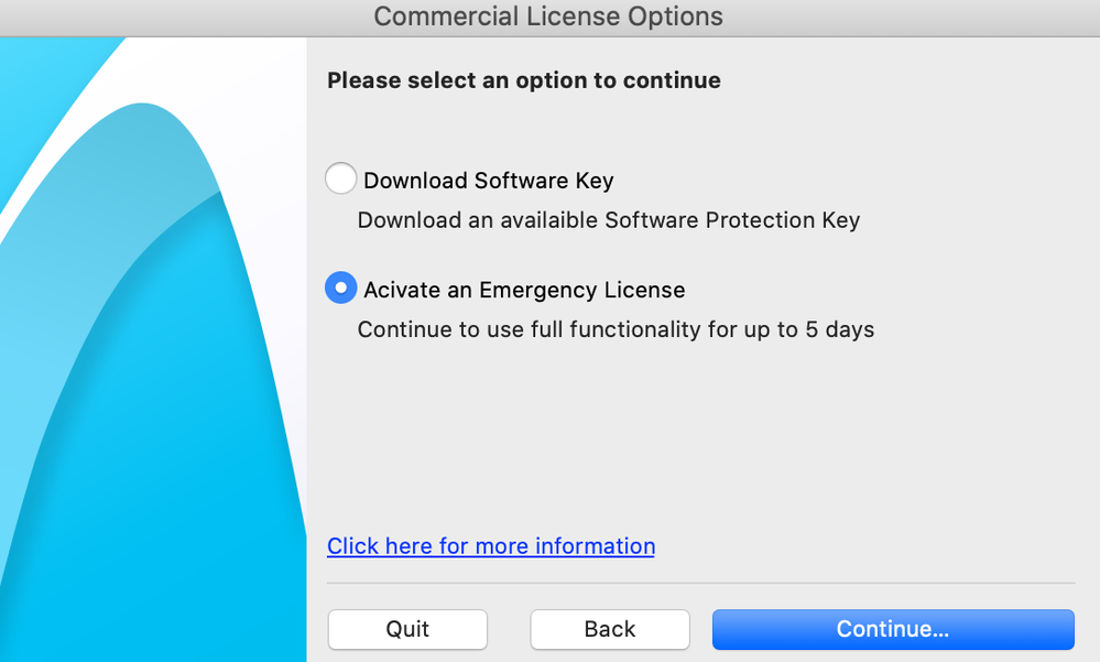

Archicad 22
  • Choose the option that says “I have a Commercial License on a Hardware or Software Key
  • On the next dialog, choose the option to “Activate an Emergency license code

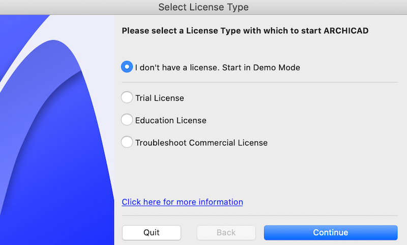

Archicad 17-21
Note
In case you are using Archicad 17, make sure to have the latest update installed before you validate your Activation Code.
Activation doesn't work from Archicad 19's Windows version. Try activation from a different version.
  • Click on the option “I don’t have a license. Start in Demo Mode” and press “Continue
  • Archicad will start in DEMO mode.

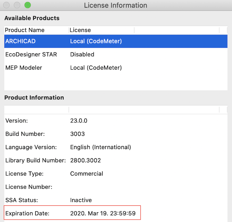

When does an Emergency License expire?
An Emergency License is valid for 7 days. The counter starts from the time the license has been activated within Archicad.
How to check the exact expiration date in Archicad?

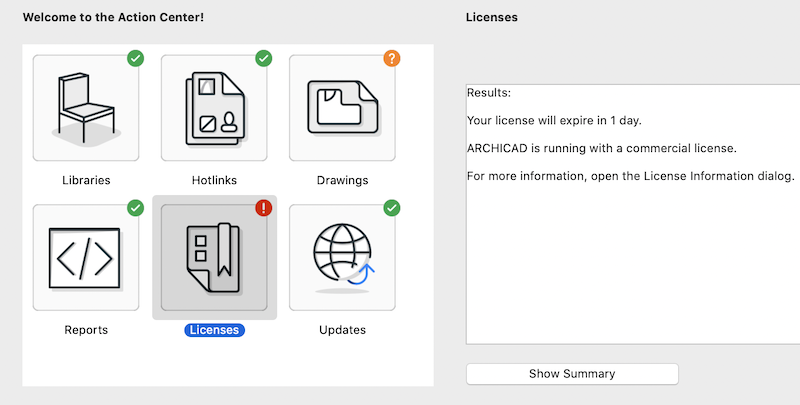

In Archicad 23 and newer you can use the Action Center to show when your license will expire:
In Archicad 17-22 you'll get a prompt popping up every time you start Archicad:
You can always check the exact expiration date in Help/License Information dialog:
