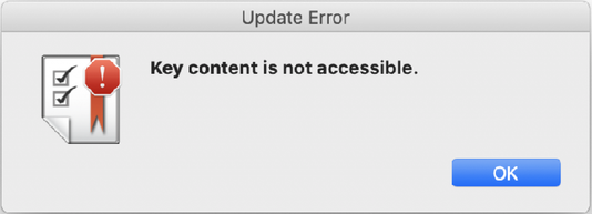

"Key content is not accessible" error message pops up while uploading or downloading a software key with License Manager Tool. This phenomenon has similarities with the Protection Key Content is Listed as Not Accessible in LMT (Code: 2009) phenomenon. Please check the related Help Center article as well.
Cause
In order to download or upload a software license, files need to be created and deleted in certain locations on the computer. If this is not possible, and License Manager Tool cannot modify these files, the "Key content is not accessible" error message appears. The main reason of this is a permission problem: the actual user of the Operating System does not have read and write permissions for the necessary folders, or a firewall or antivirus software blocks the license file management.

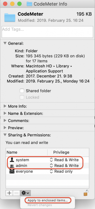

1. The current user account of the operation system should have read and write permissions for the following folders and all the enclosed items (click for screen shots):
Windows: C:\ProgramData\CodeMeter\
macOS: Macintosh HD/Library/Application Support/CodeMeter/
