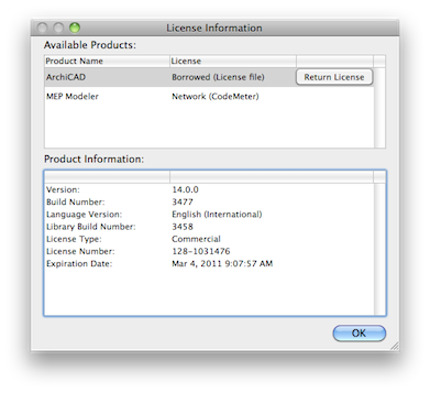

  • If the process is successful, the program lets you know that you have borrowed a license for the product, with a particular expiration date. In the License Information dialog box, the selected product’s License information is listed as either “Borrowed (CodeMeter Stick)” or “Borrowed (License file)”, depending on the form of protection used. The selected product is now shown with a "Return License" button: click here when you are ready to return the license. Once you return it, it becomes available for the next borrower.
The expiration date of the borrowed license is shown in the Product Information section. If your license expires before you return it, the program will automatically return it for you, even if you are not online. However, if your computer or local CodeMeter key becomes lost or broken during the borrowing period, there is no way to “return” the license until it becomes due (at which point it is returned automatically).

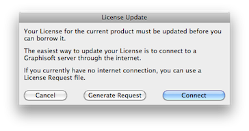

The first time you try to borrow a license – whether an “Act” (soft) license or a “Key” (CodeMeter Stick) license - you will be warned that you have an “Inadequate License.”
You must now obtain a so-called “inactive” license via an automated internet transaction with GRAPHISOFT, and then complete the Borrowing process. This is a single-click process if you have an internet connection. If you are online, click Connect. That is all you need to do.
For detailed steps how to create the inactive license file - even in offline mode - see this article.
This process, creating an “inactive” license locally before you can borrow, is necessary only once. Henceforth, each “borrow” and “return” function will alternately activate and deactivate that license file.

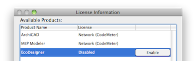

It is possible that you are running GRAPHISOFT’s MEP Modeler or EcoDesigner Star on your machine without a license key. (This means that you can view MEP elements or EcoDesigner Star interface in ARCHICAD, but you cannot edit them or access the related commands.) In this case, the License Information dialog box lists the license for this product as Disabled.
wp-content_uploads_archicadwiki_codemeter-licenseborrowing--licenseinformationeco.png
If your CodeMeter NET key contains a borrowable MEP or EcoDesigner Star license, click Enable to start using a license for the product: this way, you will have full access to its functions.

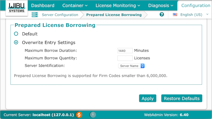

WIBU released the CodeMeter driver 6.60a where Maximum Borrow Duration and Maximum Borrow Quantity can be managed in CodeMeter WebAdmin.
  • Open CodeMeter Webadmin
  • Go to Configuration/Advanced/WebAdmin Configuration
  • Click on "Edit"
  • Turn on "Enable Prepared License Borrowing Configuration"
  • Click on "Apply"
  • Go to Configuration/Server/Prepared License Borrowing
  • Change the value of the parameters as needed
  • Click on "Apply"

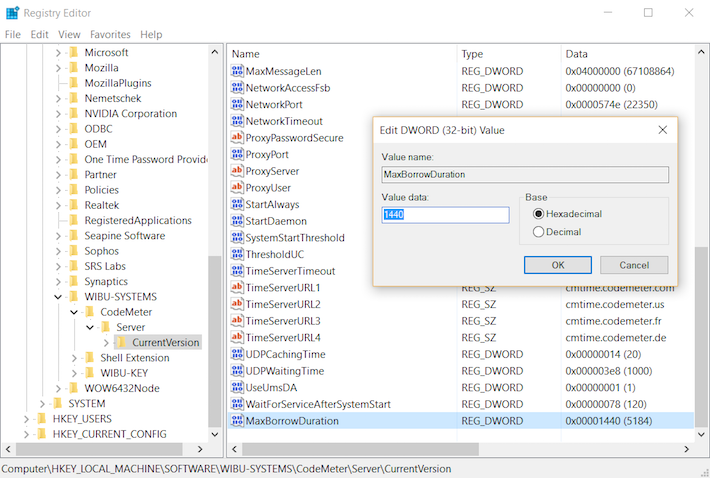

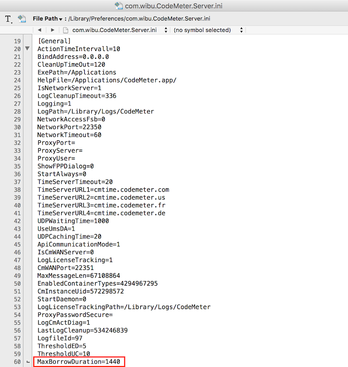

In CodeMeter driver 6.30d the Borrowing tab is not available in CodeMeter WebAdmin. If users would like to change the borrowing period to be shorter (but not longer) in minutes the following registry key must be changed.
macOS:
  • Stop CodeMeter Service in System Preferences
  • Open Macintosh HD/Library/Preferences/com.wibu.Codemeter.Server.ini file with a text editor application e.g TextWrangler
    Please note editing this file requires authentication
  • Create a new value: MaxBorrowDuration=1440
  • Save the file
  • Start CodeMeter Service
Windows:
  • Stop CodeMeter Service in CodeMeter Control Center/Process
  • Open registry editor and navigate to HKEY_LOCAL_MACHINESOFTWAREWIBU-SYSTEMSCodeMeterServerCurrentVersion
  • Create a new DWORD (32-bit) Value: MaxBorrowDuration
  • Give the Value data in minutes
