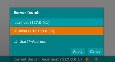

Client Side
1. Connect physical CmDongle to the Client machine to check if this key is acceptable by installed software (CodeMeter Control Center and Archicad itself).
2. Firewall rules allow connection to the Server on the assigned port (22350).
3. When you open the CodeMeter Control Center, there is a 'CodeMeter service is running' status message.
4. Open local CodeMeter WebAdmin Dashboard via CodeMeter Control Center (⌥ ⌘ W on macOS and Ctrl+W on Windows) or via direct link in browser:
Locate the white and orange round button with two arrows at the bottom of the page, press on it and you'll see 'Server found' with a list of servers found in your network.
  • If you only see `localhost (127.0.0.1)`, then no network servers have been found.
  • If you see your license server in the list, then select it and press 'Apply'.
Select serverSelect server
