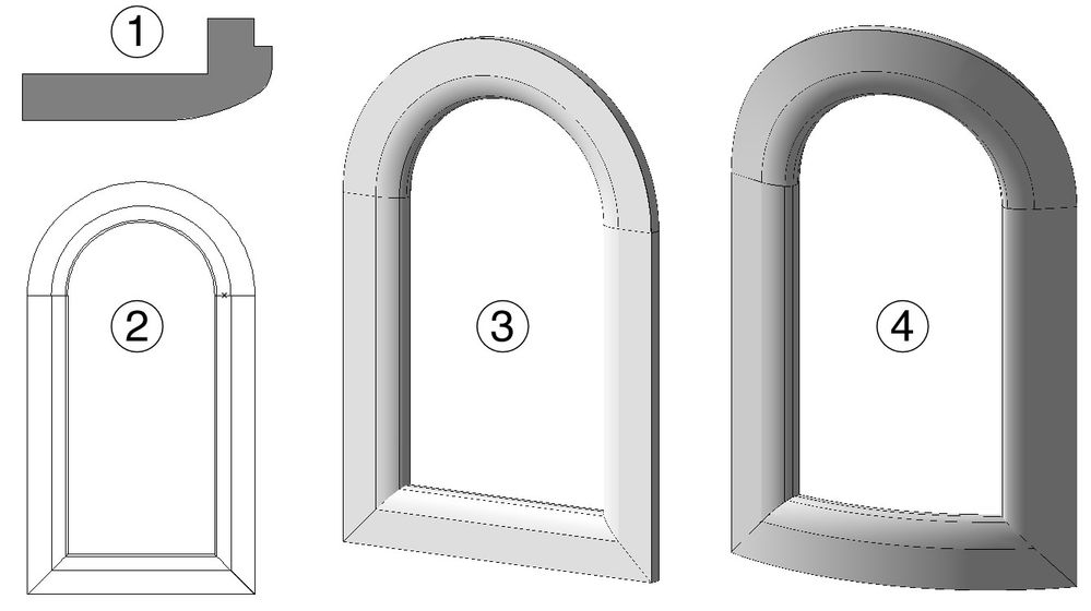

Vertical Molding
I need your help, if it's possible to do?
I need to turn molding vertically. Is this possible at all with existing samples or do I need to create new one?
I'm trying to make wall panels that have built in picture frames build in.
Any help is greatly appreciated.
Thank you.
Try OBJECTiVE - it's free to use with the educational version of AC, and anything you model will continue to work even if you subsequently don't have the add-on. Referring to the attached image:
  • 1. You will have more modelling flexibility if you make the frame moulding with OBJECTiVE. Just draw a fill with the profile you want and create a new 'Section' profile. You can use other profile objects and rotate and cut them with OBJECTiVE, but you can't bend to curves.
    2. Place the moulding around the frame edge - you can either draw directly into an elevation, or draw it in plan first and rotate to the wall plane afterward. You can bend to curves as you please.
    3. The finished frame in a flat plane
    4. You can also bend the profiles to a curved wall as required.
For more info, take a look at http://www.encina.co.uk/objective.html
