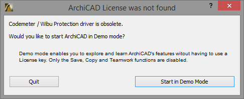

ARCHICAD License was not found: WIBU Protection driver is obsolete
Issue: Older ARCHICAD versions (17, 16, 15…) on Windows machines can’t use the ARCHICAD 18 license from a Mac WIBU license server.
Cause: This issue is caused by WIBU’s technology limitations.
Solution:
  • Uninstall WIBU driver version 6.20 from the Mac license server and install version 6.10a from here

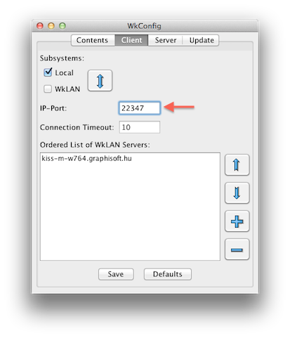

In case of using network licenses the required network traffic should be possible. Make sure on all related firewalls (client, server) the port that is used by the Wibu driver is open. By default it is 22347, can be customized in WibuKey settings/WkConfig; all computer should have the same ports specified.

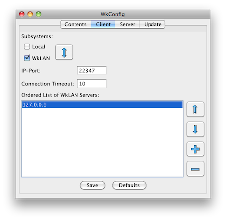

Users upgrading to ARCHICAD 13 (+) can experience the following: if you start ARCHICAD on the same machine where the key is plugged, then ARCHICAD 13 will use it as a Single key, and no other users can reserve licenses on this key. This behavior is new in ARCHICAD 13! To run ARCHICAD on the key-server machine:
  • stop Wibu server
  • disable ‘Local’ Subsystem in the WkConfig .app (Mac) or in the WIBU Control Panel (PC)
  • specify server address 127.0.0.1 (localhost) as the WkLAN Server.
  • Then run the Wibu server
  • Start ARCHICAD.
The required settings on Mac:
