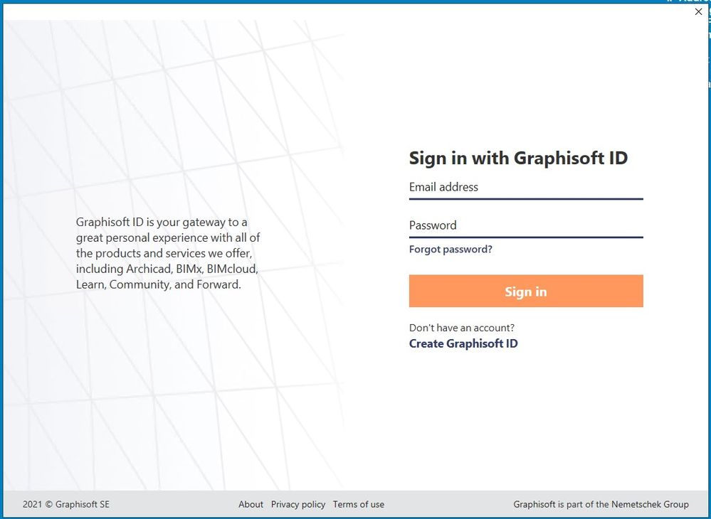

I have a problem regarding moving our license server to a Windows server 2019.
When i try to login at License Manager Tool, the "Sign in" button wont work.
Any thoughts what i could be, all other buttons are working.
I have tried to reinstall the software.
I have added the site to our "Trusted sites" in IE
Best regards
Tomas Eklöf

Can you try in different web browsers?
I use Firefox and it works there.
ryejuan
There are some issues with the sign in button with regards to display settings (scale and layout) specially if you are trying to login directly within Archicad. Hope this info helps you out. 😎

I assume the License Manager Tool uses whatever the default browser is.
Looking at your original image, the orange sign-in button will not be active until you enter your user name and password.
The button should then become a darker orange colour to say it is active.

sorry for the confusion, usually Archicad itself will have that login screen in the beginning if you haven't signed in your GS ID then display scaling becomes an issue.
Then if you have problem accessing or pressing the sign in button try changing browsers usually it solves the issue. If still not working maybe got firewall issues, need to look into that too.
@Barry Kelly the orange button is active on my end even if I didn't key in any username and password.

No worries, my thoughts is that this is a firewall issue aswell.
I have sent this to our IT department, i will see what they will find out regarding this.
/Tomas
Hi Barry,
I have tried to change the default browser o the server, but it always start with IE.
I will send a case to Graphisoft and see if they have seen this problem before.
