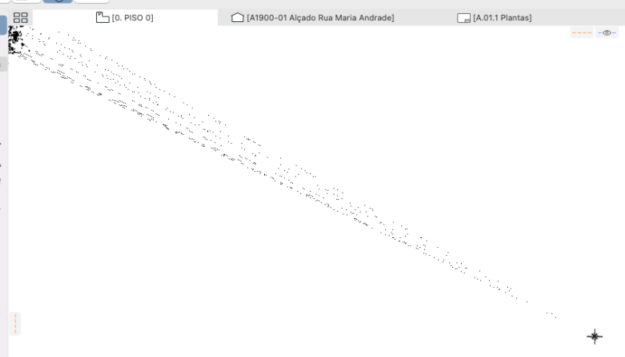

hi, I have 2 problems to solve that are probably connected: 0,000000% zoom and missing survey point.gsm. Please see attached images.
Thanks

IFC.apx is an add-on I believe.
It does not seem to be a default one that comes with Archicad.
Check you add-on manager to see if it is loaded.
If not you will need to add it.
I assume that add-on creates the survey point you are missing.
If not then you need to load that survey point object with your Library Manager so it is not missing.
The 00000% zoom is probably because there is something very far from the project origin.
Is it best to model close to the origin in Archicad.
AC25 (not sure what version you are using) has a built in survey point that can be placed far from origin and shouldn't affect anything.
But you always want the building model close to the origin.

My guess?
A file created before AC 25 and then migrated.
The "Survey Point.gsm" will obviously now no longer be available, since it got replaced with the native tool.
Regarding the visual glitch, it could also be due to a bad driver. Updating those could help.

Thanks for the help…I’ve found 3 stairs on the same place in different stories that were taking the zoom extend to 0,000%. That problem is solved.
Regarding the Point Survey.gsm I haven´t found a solution. The object doesn’t exist in the model. So I cannot find the black spot and erase it. The only option that I think of is that this gsm is incorporated in some object of my libraries that is not being used…but if this is possible, how to know which one ?!

I regularly have the same problem (0.0000% zoom). Somehow it's related to an error with stairs. When I delete the stairs the zoom problem is always fixed. But then the stairs are gone, so it's not a working solution.
