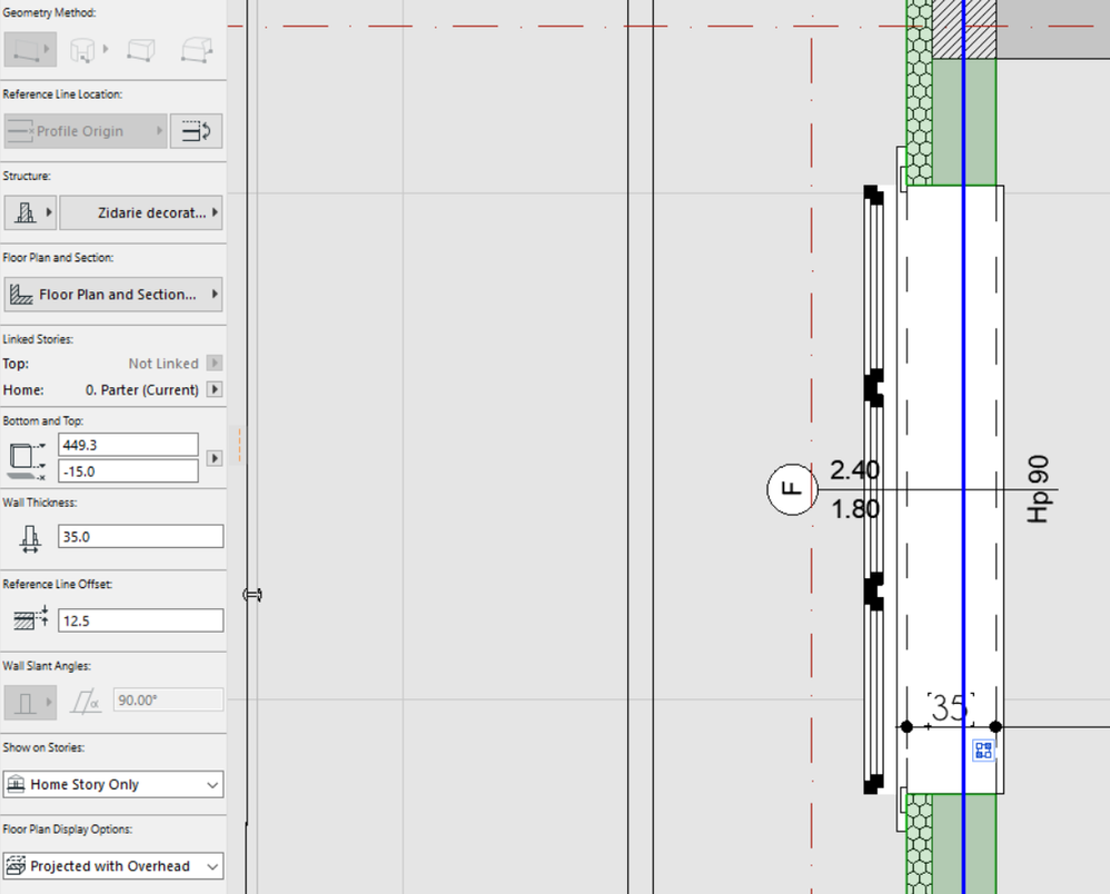

Hello,
I created a wall with profile manager (because i wanted some horizontal lines on the exterior skin). So in 2D the reference line of the window is at 12.5 cm, but in reality it is shown outside the wall. However, in 3D it is shown correctly at 12.5 cm.
What am i doing wrong?

drexdis:
In the Profile Manager for the Wall, turn on and check the location of the Opening Reference lines.
David

That worked. Thanks
