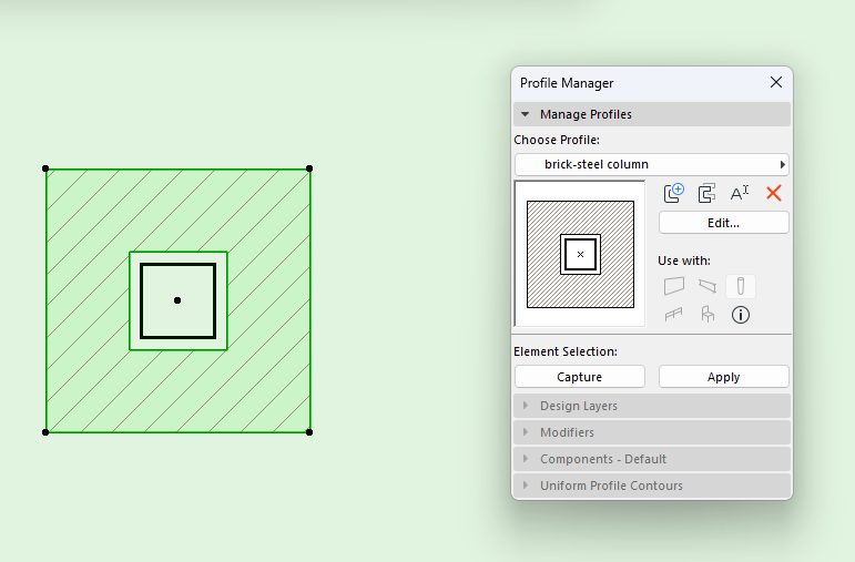

Hi all, I wanted to ask, what is the best method to model a 350mm x 350mm square brick column made out of 110mm wide bricks, with a 90mm x 90mm SHS steel column in the center ? Do I just draw each column and then drag the SHS to the center ? When cut through on the floor plan, I want to show all the brick skins cut through correctly. Do I just do it with 2D tools or is there a better way to do it ?

You could do it with 4 walls in a square (no need for wall ends) with a steel column in the middle.
But you will have separate elements to manipulate all of the time.
But a single column is much easier to place and move.
As far as quantities, the brickwork should be correct but the centre steel post will not count as a single steel column.
I am sure there will be ways around it to get the correct quantities, but I don't do that myself, so I couldn't say for sure.
You can also add modifiers to the complex profile to adjust heights and widths of various parts.
Also combine multiple complex profiles in a segmented column.
This is one column and actually is just regular segments and not complex profiles.

Create a complex profile column.
I haven’t yet tried that method yet but I will give it a go.
Anything wrong with drawing a 350mm short wall and using wall ends with a returned skin and then placing a 90 x 90 SHS steel column in the center ?
