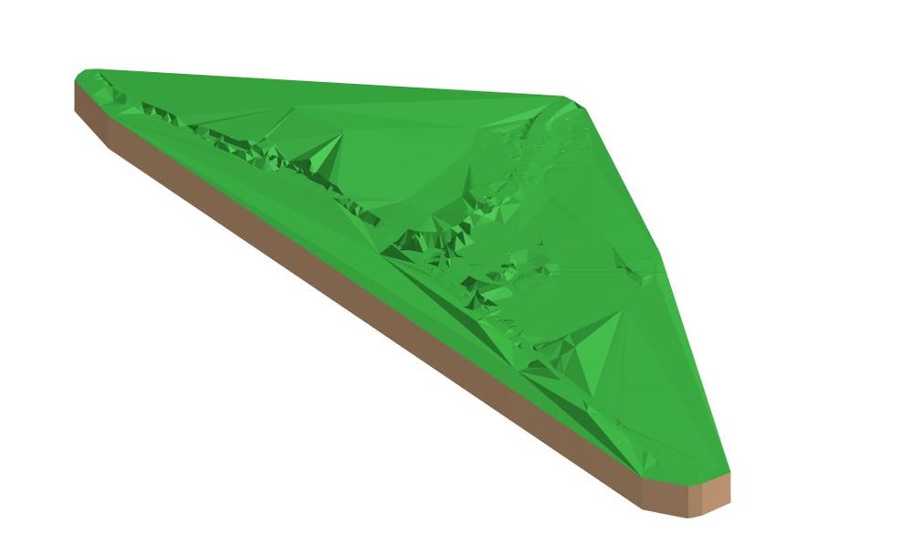

These points are all around a certain shape... please see if you can obtain anything different from a terribly sad spike field
AC14 result is:
You can download the .pln in AC13 from here:
http://www.mediafire.com/file/4k9fck276mivrl4/Mesh_punti_AC13.zip
Ok, that's what I mean. Thank u very much for trying but can you that it looks like a spike field, not a real terrain? I mean, why does it have to be so sharp? In your experience, isn't there a way to make it look like a real terrain?
Change settings of the Mesh:
