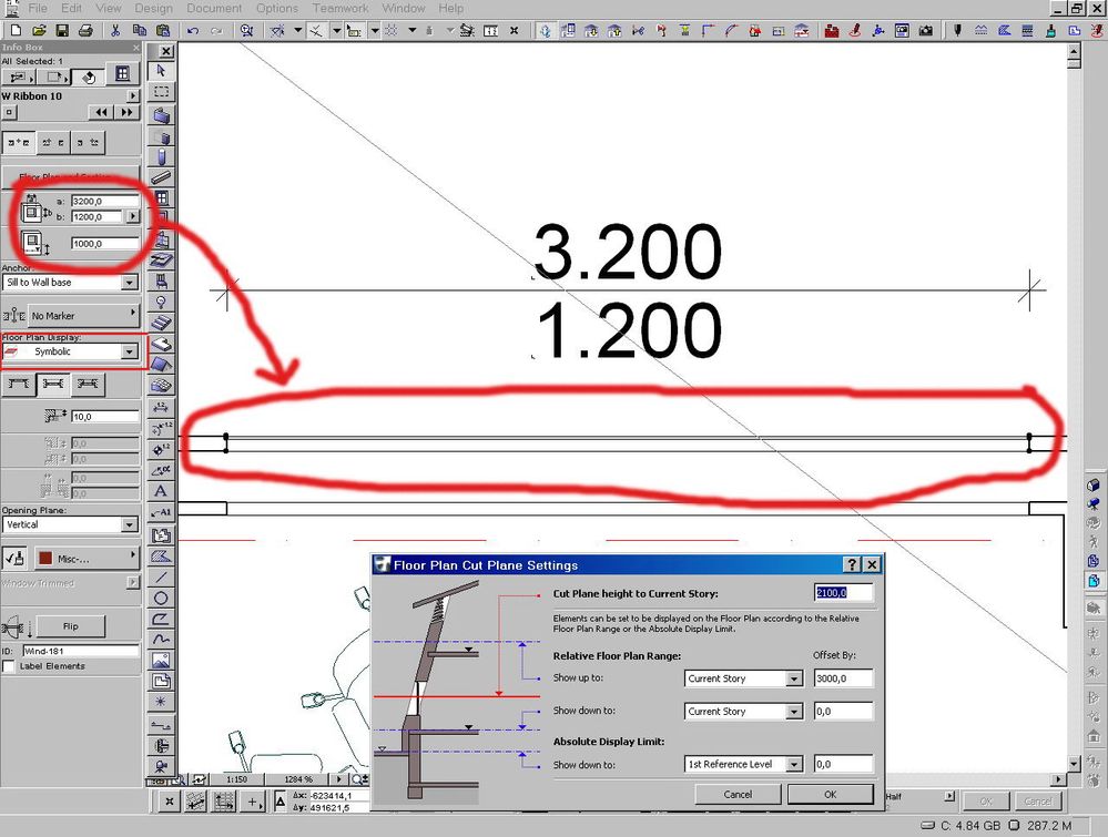

I'm using AC 10 (1010 update) and I'm having problems with the representation of windows in the floor plan. To be more specific, it seems that the windows' frames cannot be displayed, no matter what I do (I've tried both symbolic and projected types of display, but with no result).
I have attached a print screen file with an example of this problem (you can see there my window's and the floor plan cut plane settings).
Please, could you give me some advise that could solve this issue?
Thank you.

What is the detail level of the window set to? Most likely, it is set to "scale sensitive" or some other setting that is turning off the frame.

TomWaltz wrote:You are so right! The detail level is set to "scale sensitive". I've changed that to "detailed" and now everything is ok.
Thank you so much !
