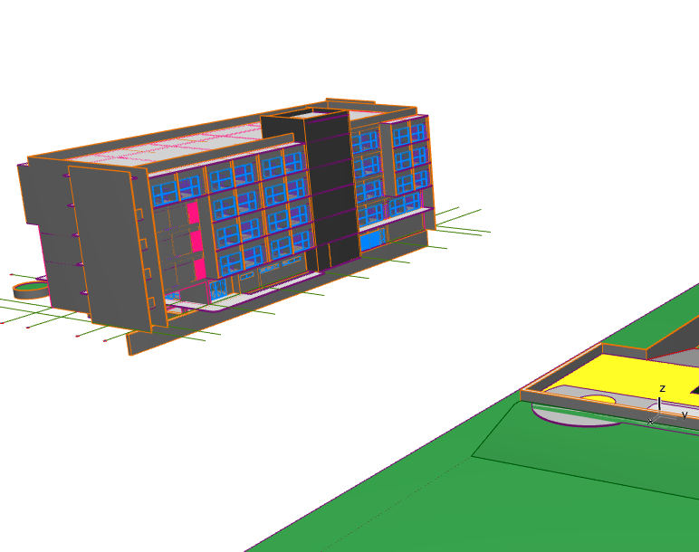

Real world sample. This project was started in 15, the owner wants some changes that causes the story levels to change. Prior to 16 I would edit the levels to match the new ones and keep working using the previous design as a reference for the new one.

and after adjusting the levels to the new ones that I have to match.

That is the whole issue. Prior to 17 stuff stayed put and the integrity of the model was maintained. Now editing "story settings" (which by the way is undoable) can wreak havoc if you don't prepare the model beforehand or if you don't design them from the start.
Just imagined if an intern decides to adjust the story levels by 1" on a 10 story tower and everything changes except for the stairs (which are not linked), then you building exceeds the maximum height for that lot and the A/C ducts do not fit when the added inch is removed. In the old way the model would not move by itself and you would catch the +1" error on 2D documentation, now the model will fix itself and who knows when you would catch it (if you make a section thru the stairs you might see it).
I know that we can get used to it but the flexibility we had is lost and we have to develop new workarounds when previously we didn't need them.
