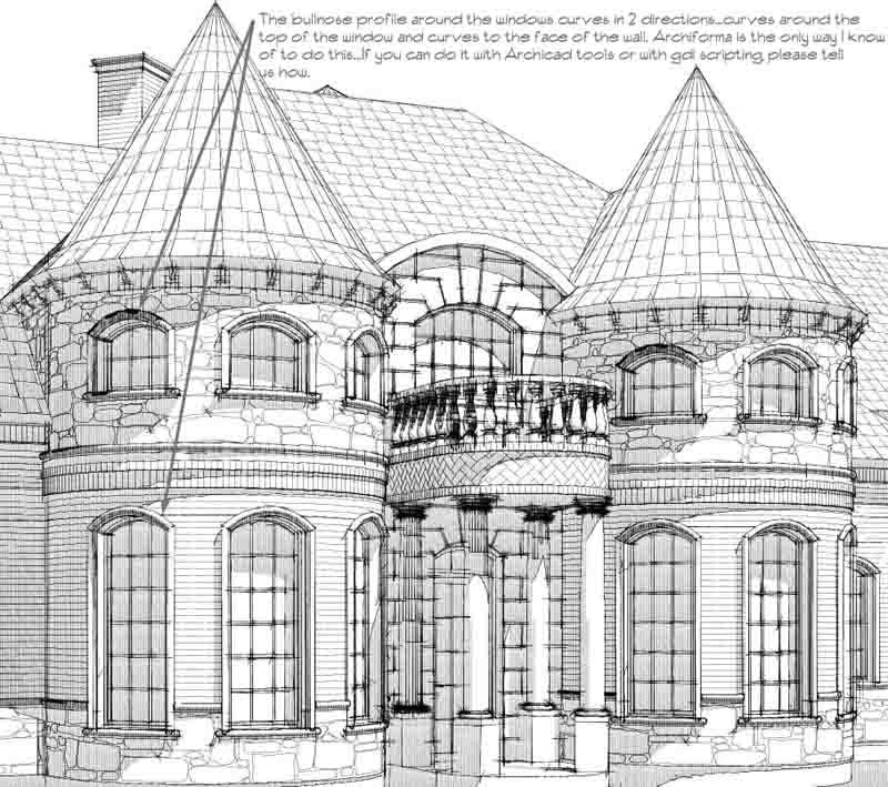

There are many reasons why I use Archiforma. the best one to describe with the attached image is the ability to ceate an element that can curve in two directions...see the image for description.
The other main reasons are: ease of use, editability and I don't need to maintain project specific libraries if I create things out of archiforma.
I do alot of projects that require detailed half-timbering...I the past, I would model a whole wall of this half-timbering and then save it as an object to apply to the face of the building. It became cumbersome maintaining the various parts and especially cumbersome if I ever needed to edit them. When I discovered Archiforma, all that hassle was eliminated.
Dan, would you mind, if u have a chance, sharing your procedure to create
a double curve profile using archiforma ??
Rakela,
It sounds more cumbersome than it really is...below is the process I used to create the window surrounds in the image I posted previously...so here goes:
1. Generate a 3d projection of the desired window and copy the line work out.
2. Paste the linework down on the floor plan and use ArchiCAD's polyline tool to trace the window outline...be sure and add extra nodes along the arc part (I usually add at least 8-12 evenly spaced nodes along the arc.)
3. Draw the desired profile using archicad's fill tool...select the polyline and the fill and use ArchiForma's "Tube-Sweep" tool to loft the profile around your polyline.
4. Place a section elevation marker at the top of your new profile (note: your profile is laying flat and you will be viewing an elevation view of the top of it.)
5. Go to the floor plan view of the window and draw a polyline or arc of the curved portion of the wall where the window is...copy the arc and paste it back into your elevation view.
6. Line the pasted arc up with the profile...select the profile and graphically stretch the notes to meet the curev of the pasted arc.
7. When you're finished editing the nodes, go back to the floorplan and rotate the profile up using ArchiForma's "Rotate" tool.
8.You're done...after you do this a few times it becomes pretty easy and quick to do...Good Luck!
