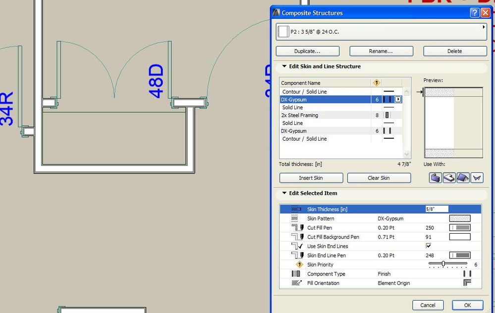

Having an issue with wall intersections where one wall "Tees" into another. This is a composite that was used in AC14 and I had no problems with it. I've tried everything I know in AC 15, skin priorities and, layer priorities, even checked model view options?? Also set renovation status of all walls to new & show with no overrides. I'm sure it's basic but I've spent a couple hours searching and fiddling already....

I'm guessing that your reference lines are not touching? - required for clean-up.
Unfortunately they are...
Did you enable skin priorities of that walls?
See the picture to know what did I mean.
