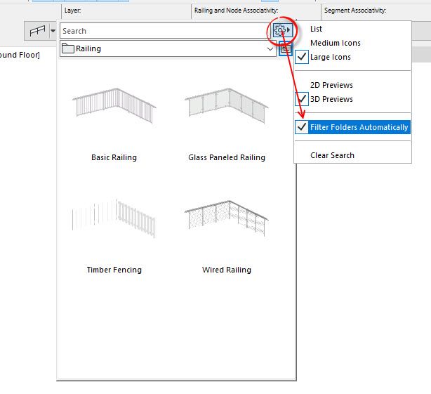

so, we have no video tutorials of exactly how to do the AC21 railings. fine...so then how/where are the railings that I can associate to the stairs that have the "wire rails"? How can I adjust the railings to contains those "wire rails"?
(see attached image) I need the railings on the stairs which are currently associated to look like the "wire rail" on the left.....how can I accomplish this?

The railing and stairs are hierarchical elements - like the curtain wall tool.
So there aren't multiple stair or railing objects as such.
There is only a set of parameters that you must adjust each time you use them.
That is why when you have something you like, save it as a favourite.
Using a favourite will set all these parameters for you.
I am hoping that Graphisoft will be able to share a lot of different favourites for the stair and railing tools for various 'generic' setups so that the users have somewhere to start editing to their specific needs.
As has been pointed out to start from scratch can be very confusing and time consuming if you don't know what you are doing (and I am certainly one of those people - there is a lot to learn).
A tip with the favourites is to go into the settings and activate "Filter Folders Automatically".
This way you will not have to browse through the entire folder structure in each tool - only the relevant folders will display.

Laura Yanoviak
rob2218 wrote:
Also Laura...how do you activate/trigger to get those two vertical dashed lines in the "sketch panel"? I don't see my right vertical dashed line.....only see the left one and can't seem to make/establish a "panel pattern"?
I sent Rob a PM explaining this, but for everyone else's information:
A "Pattern" (the area indicated by the two vertical dashed lines) is established by the location of an Inner Post. “Inner Posts” occur within Segments; “Posts" occur at Nodes.

Electric Flute
Hello Rob, see link below. It has clear information.
https://helpcenter.graphisoft.com/tips/archicad/modelling/railing-tool-basics-pattern-distribution-settings/
