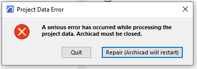

I'm getting some serious crashes after I go to the publisher sets and navigate through it:
Steps that makes a file to crash:

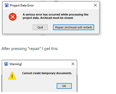

After pressing "repair" I get this:
And my project file comes corrupted, which means I've no longer able to open backup files. After a lot of time to restore all steps in the project before this error I'm still unable to use publisher because of the AC crashes everytime I do these 2 steps.

Is it just that one file or does it happen to all files?
If just that file, have you tried the 'Open & Repair' option on the file yourself?
If that does not work, have you sent the file to your local support for them to look at?

2022-08-29 08:34 AM
@Barry Kelly ,
'Open & Repair' has worked just fine.
Apparently, something was bad with my file.
But, these two
is still a mystery for me.
Anyways, thank you!

2022-08-29 09:44 AM
I have never come across that 'Project Data Error' message (touch wood!).
The 'cannot create temporary documents' could be a user permission problem depending on where it is trying to save the files, or maybe a full hard drive?
But that is just a bit of a guess.
