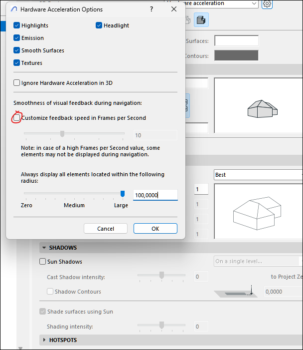

I tested this registry fix to a certain file which suddenly started to be laggy. It wasn't happenning since the beginning but I cannot figure out how it started.
In any case the 3d window was not responding with both my mouse and the 3dconnexion mouse. No smoooth movement but broken.
I applied the fix and the problem was fixed!! To be honest I wasn't expecting this as initially I thought it was related to the model.
Before I applied the fix I did another test with the FPS slider in the 3d styles Advanced Acceleration settings.
I enabled the the FPS and set it to 25. I got back to the 3d window and then reopened the setting and disabled the FPS.
The  3d model was absolutely smooth even with shadows on. If you cloase the 3d window it reverts back to the initial problematic state.
For sure something is wrong.
@MASz , before changing the registry can you check as a workaround if enabling-disabling the FPS slider has the same positive result...?
