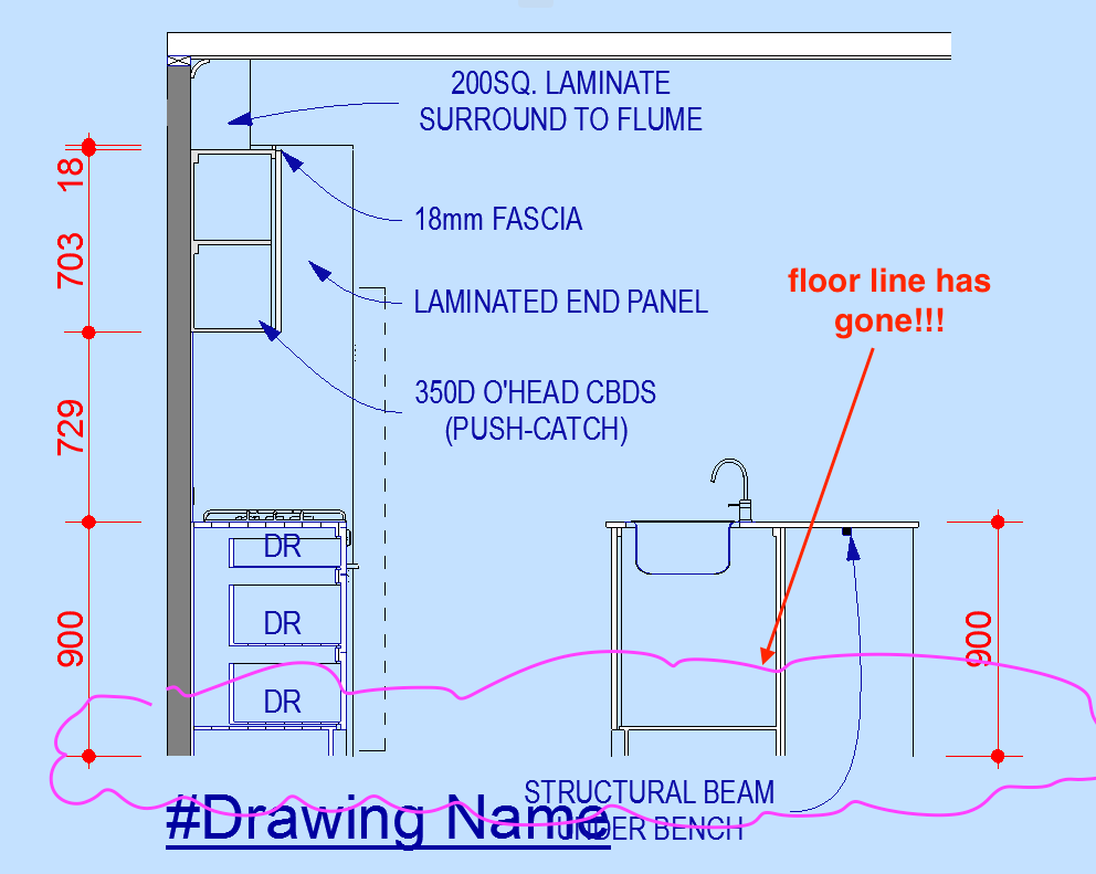

We have found a serious bug in 6005 (Windows). The floor line of all our internal elevations (using the elevation tool) has disappeared in all projects. We are going to roll back to the previous hotfix if there is no 'easy' solution to this issue.
If you could get back to me ASAP it would be appreciated.

Hi Ben,
I seem to be getting mixed results.
File based on my template seems fine.
But one I got from an external source has the missing floor.
But only if the section/elevation cuts the floor slab.
If the section/elevation line is in front then the floor top surface shows fine.
If I copy and paste my slab and section from my template to the other file it is fine there.
Add a new section line (using the default settings in the external file) and it doesn't work.
Transfer settings from my section to the other and it then works.
I figured out the only setting that was different was the boundary display was set to 'No contours'.
Changed it to 'Uncut Contours' and all was good again.

Yes our default is 'Uncut Contour'.
I can confirm that the floor (walls, ceilings) in section at the limits of the elevation extents did used to show in build 5025 and they no longer do in build 6005.
I am with you that when these elements are cut by the section/elevation line that cut edge should show regardless of the contour setting.
An element beyond the section/elevation line will show when at the extents so surely an element actually being cut should show as well.
Csaba Kezer
Hi Ben & Barry,
Indeed we changed how we show contour lines of elements that have only one of their edges present in a S/E/IE. Previously we showed the contour lines of such elements with their Cut/Uncut Line & Pen, disregarding the setting of the Boundary Display function. In the new Update we take the Boundary Display setting into account:
- Uncut Contours: the contour line is displayed with it's Uncut Line & Pen
- No Contours: the contour line of the element disappears
- Override Contours: the contour line of the element gets overridden by the Line & Pen set as the override
So from this point the software works in a more logical way than before. At the same time I see your concern. If you have only an edge of an existing element present in a section, then you not necessarily want to replace this line with a special Boundary Contour. I guess what would make sense to have an On/Off checkbox for the Boundary Contour setting in the S/E/IE View Map settings with having it Off as default. This way your drawing's edges wouldn't get compromised, unless you specifically want them to be.
