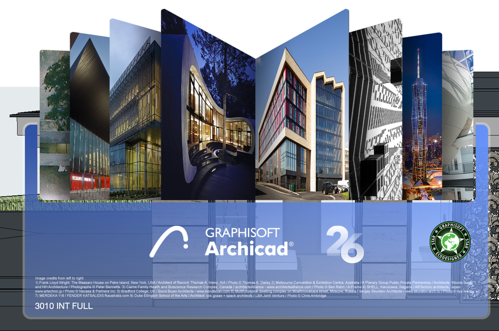

And just to be sure you have run the latest update - I believe there is an update 3010?
