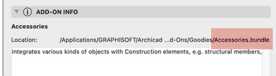

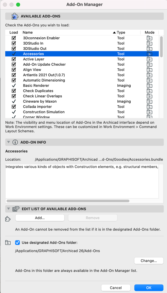

Can you show an image of your add-on manager?
AC 26 3010 INT FULL
iMac (27-inch, 2017), macOS Monterey
Thanks for that.
Clearly it is installed.
But it seems not to have created the menu structure.
I am not familiar with Macs at all, but I see in mine it is installed as a .APX file.
In yours it is a .BUNDLE.
I have no idea if that is correct or not.
Now when you go into your Work Environment > Command Layout Schemes, does it show a named scheme or is it 'Custom'.
If 'Custom' try applying a named scheme - again I have no idea if this is the problem.
