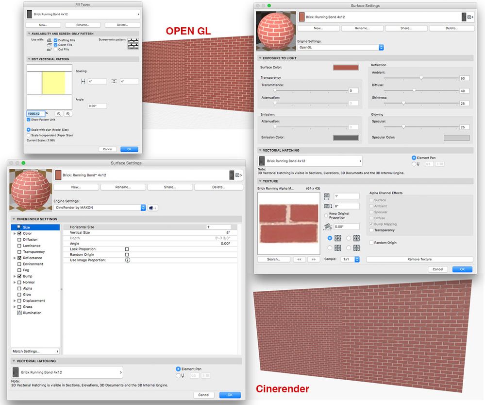

So I have been using brick on my last two projects and I have some tips for you.
- First you need to make a Fill 4x12 duplicate the runing bond fill and change dimensions.
- Duplicate the brick texture and change the texture size in Open GL and Cinerender
- Apply new 4x12 vectorial fill
