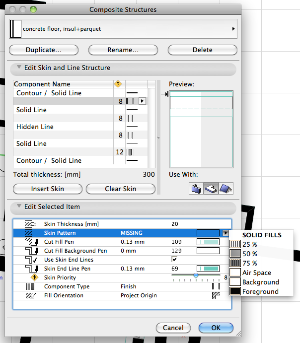

I dont know when it happened exactly, but all of the fills such as those used as the cut fills in walls, or the skin pattern fills in composite structures are missing in all of my elements.
the only remaining options I have are foreground, background, air space , 25/50/75%.
All other functions are working as they should, to my knowledge.
Any idea where they could have disappeared too? I have run the repair install but it didnt have any effect..

Hi joe_w,
maybe try this option:
File -> New -> New & reset all
ArchiCAD should restore everything to its defaults. Then use Attributes Manager to copy fills you want into your project.
Other option is to use Attribute Manager to copy attributes from your other projects.
