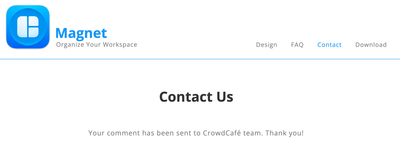

I've sent a short report to CrowdCafé (developers of Magnet) to look into the issue.
I'll keep the thread updated once they reply – hopefully they do and the issue gets resolved (I'm not sure on whose end, though).
