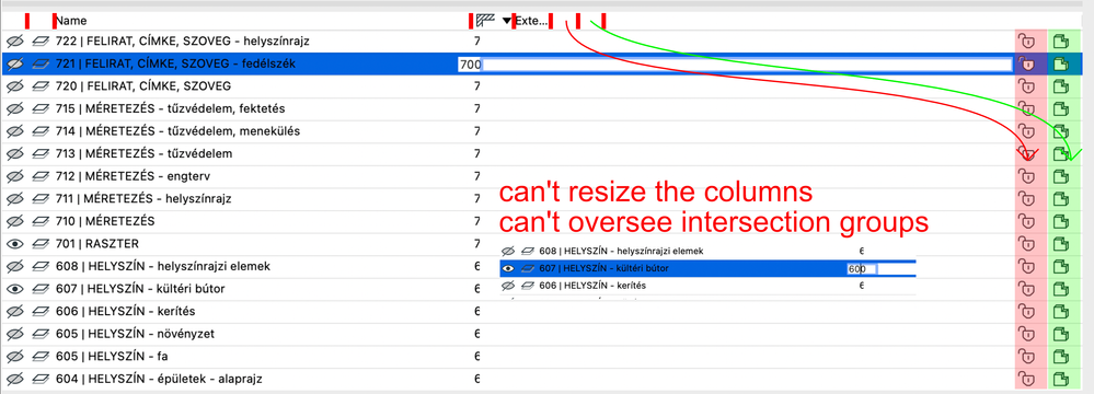

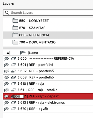

I don't know if anyone else experiences this, but this is driving me mad:
1) Go to the layer manager, and try to resize the columns (visibility, wireframe, name, extension, intersection groups, etc.)
2) I cannot grab the vertical (red in my screenshot below) bars and resize the columns, occasionally I can click on one edge of the "Name" column.
3) A "cosmetic issue", but the columns themselves do not line up with the red bars (see the highlighted last two for example).
4) A serious problem is the complete inability to work with intersection groups: which ones are matching? I have no idea, because I need to click on each field to display the number at full length. I received this file and I have to understand how it is set up, because I need to deliver some renderings and the intersection groups are clearly wrong. I can't see what's going on, selecting multiple rows only show the first item.
5) All my AC27 files are behaving like this, not specific to particular files.
Screenshot:
Seriously what:

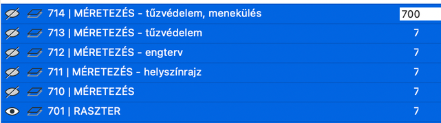

All of the highlighted items are "700" not "7":
M1 Max MBP, macOS Ventura 13.6.4., AC27 INT b5003

The name column is the only column that can be resized.
All of them can be moved, so you can have them in the order you want.
The intersection group column should be wide enough for 3 numbers - in fact I can show 5 numbers in mine.
I always thought that was limited from 0 - 99  - I must have been imagining that!
Having said that, I am on Windows, so another MAC user will need to test your issue.
On my PC it shows up to 5 digits (99999 is the highest I can get).
I don't know why it shrunk to show this few digits, but that is issue nr.1 here, the other is the mismatch between the column "headers" and the actual columns (in your screenshot it is aligned - as it should be) is nr.2 here.
I can't reset this by changing the work environment to the default and I can't solve this by changing my screen resolution either – I'm out of ideas.

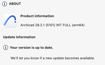

Let me resurrect this thread, the same UI glitch is happening with AC28 (macOS Sequoia 15.4.1 (24E263), M1 Max MBP) too.
I have nuked the preferences for AC28 as described in the linked thread.
Note: AC28 was a clean install otherwise. I had AC27 on this machine, which I didn't remove before installing it.

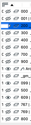

Layer intersection numbers are not shown to their proper width and I can't change the order of them (the black panning hand displays and disappears):

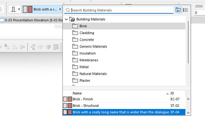

Other UI parts are affected: for example, finding building materials for walls or slabs is proving to be a challenge, the ID columns are off the screen and I can't resize:
I have just bumped the AC28 install to the latest available.
Any ideas on how to make this usable without wiping all installed Archicad instances?

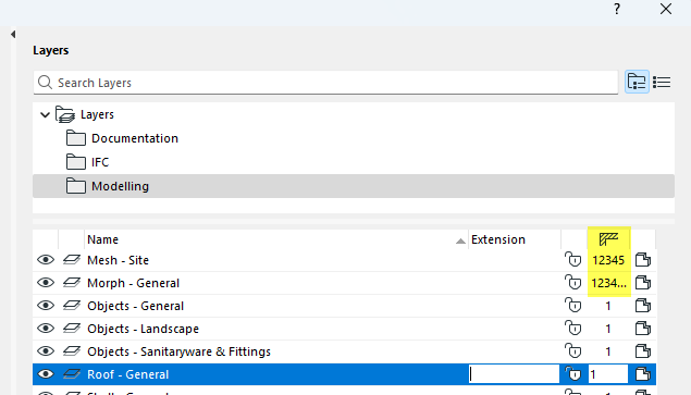

Can see up to 5 numbers in layer dialogue (this can not be stretched).
And building material for walls resizes based on the length of the name with the ID still showing.

FYI, removing all Archicad preferences (corresponding to every installed instance) solved it – removing only the AC28-related files did not.
