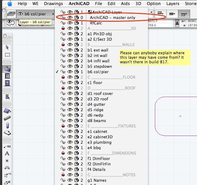

Greetings all,
Is anyboby able to shed light on the recent automatic creation of a layer called -
Archicad - master only.
It has occured only since latest hotfix 966.
No matter how many times you delete/change name it reappears next time you open layer window.
It always appears below the default Archicad layer.

I take it your have by now discovered this is a Cadimage problem. I encourage all users of their (generally excellent) products to email and encourage them not only to fix this but refrain from solutions that automatically create layers, fills, anything. This is a disruptive practise that must end. Surely there are other ways for them to achieve their goals.

Rod Jurich
Geoff, thanks.
I knew someone would have a solution.
Just downloaded a trial product from Cadimage.
Some of their parts are quite clever but with hidden scripts and the generic way some present it makes it impossible to modify any of their parts for local conditions.
This part could save me a couple of steps, but the intrusion makes my decision to not purchase easier.
At times these 3rd party parts try to cover all bases. More often never really achieving a satisfactory result. I'll be staying with my simple but better looking parts.

Bruce
This is their notice of the fix
http://www.cadimagetools.com/pages/archicad%20master%20only%20layer.pdf

This is what the 'Master only layer" notice says...
ArchiCAD – Master Only Layer
The ‘ ArchiCAD – Master Only’ Layer is a special layer that is created by the
Cadimage Update All Add-on. This is a layer that is shown when you switch to a
Master Layout and hidden when you change to any other view.
This allows you to add guide lines or place holders to the master layout without them
appearing on all of the layouts. The Cadimage Key Notes tool allows you to place a
placeholder schedule on this layer with the parameter settings and position for schedules
to be placed onto the layouts, and the new Cadimage Revision Manger tool also uses
this layer so you can add placeholders for revision information.
Unfortunately the first version of this tool was a little overzealous with updating the layer
settings making it impossible to have anything but a custom layer set as this layer was
always being updated.
The new version of Cadimage Update All has this fixed so that it will no longer affect the
layer combinations.
However you do need to make sure that this layer is hidden for your layer combinations.
This will always be the case unless you have saved the layer combination whilst on a
Master Layout.
