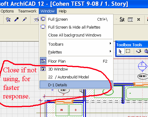

i'm having the same problem. Periodically, the file will pause, for up to a minute or so, for no apparent reason...this can happen switching between views, copying and pasting, deleting...any number of commands. This seems to happen more with team-worked files as co-workers are having the same problem on different projects. we use modules, hotlinking all model info to the project model and creating all sects./elevs./details/layouts from this 'composite' project model. The archicad library is working off the C drives, but the project library is on the server. the file sizes range from small (15 meg) to very large (140 meg). So, there are a lot of variables that could be the problem. What is the best method to trouble-shoot this problem?
cw
Look to see if you have multiple "views" open under Window.
If your just switching from one to another, they don't necessarily close,
even if you have closed the file with these "views" open and reopened file.
You have to click the small x in upper right hand corner for each view as far as I know.
As things go slower, I go to see if I have multiple AC "views" open, and close them, helps a lot for me.
Bier
While in the Floor Plan Viewpoint, you can use the Window\Close all Background Windows to close them all.
