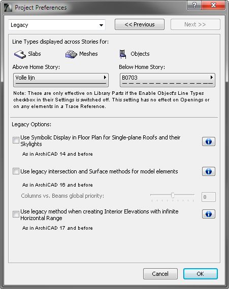

Switch to legacy mode to see if that speeds things up?

Something you need to know is that the Priority Based Connections are internally made by ARCHICAD by performing SEOs. So they could have similar effects, I assume.
