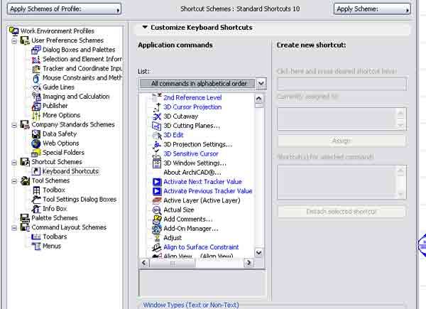

Greetings...more puzzlement. Please see the attached jpeg:
*why are some fields BLUE?
*why are others BLACK?
*where can I find more TEXT fields, and the USER DEFINED fields?
Not sure why I can't find this in the manual...
thanksthanksthanks

I am not positive but I think the Blue ones are new to AC 10 while the Black ones were available on AC 9. I heard this somewhere I think.

Blue are ones you can edit in the schedule. Black ones you cannot.
you are correct but not on this parameter list

gold star to Tom; I'm still in AC9.
That's not a parameter list. It's a list of keyboard shortcuts.
