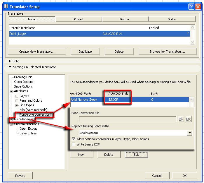

constantine,
The best thing for you to do is to find out what the STYLE name is that they are using in AutoCAD.
Then you can, as I have shown in the attached image, translate the AutoCAD STYLE to any ArchiCAD TTF font you like.
If you don't know the STYLE you can always take the second option, "Replace missing fonts with" then choose the desired ArchiCAD font.
BTW. Referring to *.SHX files does not work in ArchiCAD 8.1, ArchiCAD simply ignores them. ArchiCAD 9, however, can take help of the *.SHX files.
