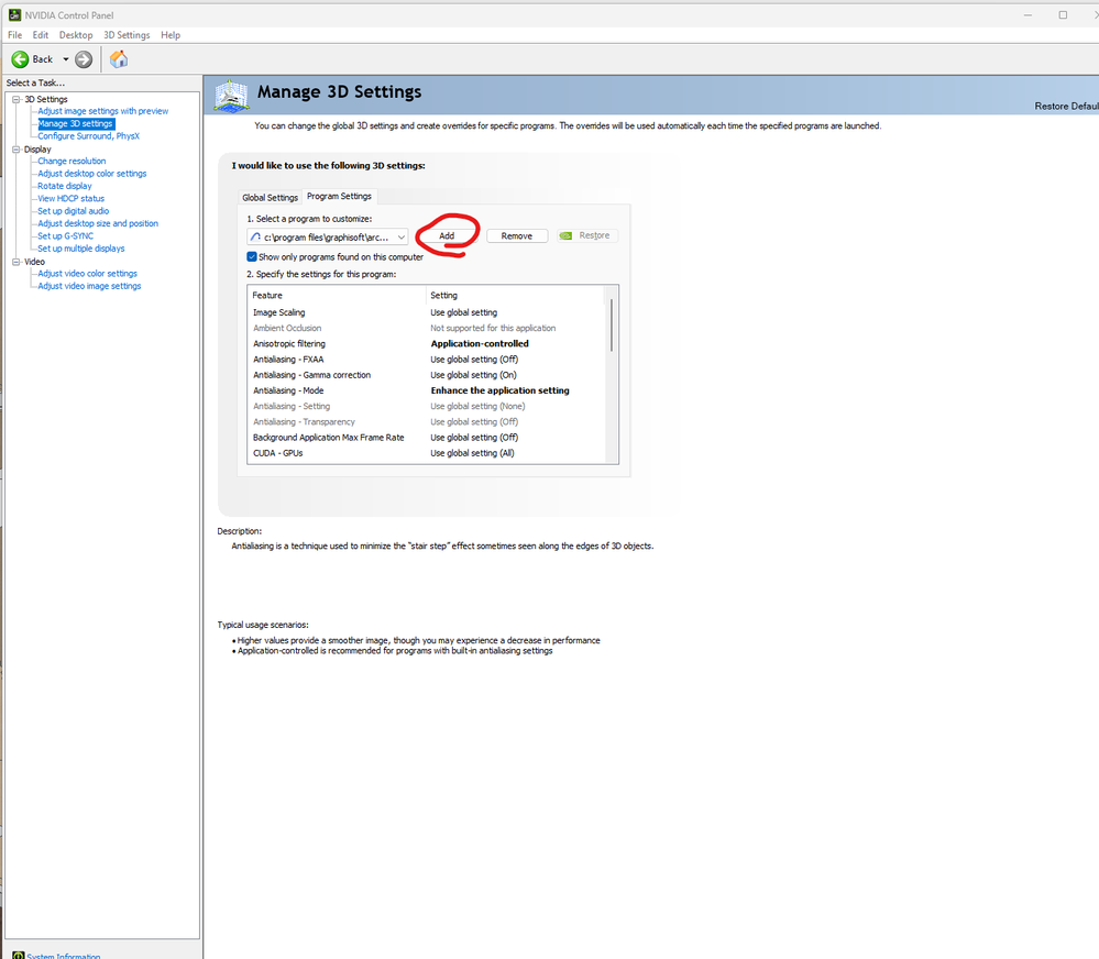

Marc H
Echoing others somewhat, but here, quickly, are a few things I've encountered:
- Workstation reverts to integrated GPU.  -> Check AC is using your dedicated GPU.
- Large, embedded library objects, often from Revit converted imports.  -> Move your own equipment and furniture objects (most often the culprit) to an external directory folder.  Sort the directory to identify the largest GSMs (if not in an LCF). Consider replacing with a more efficient version or simplified shape.
- A corrupt model element.  Normally will give an error, though. -> Open error dialog detail to dial into the source.

Milan
Snimak ekrana 2024-06-24 090859.pngI deleted embedded library completely, and about GPU usage, is needed to be set in Graphic Card settings, right?
