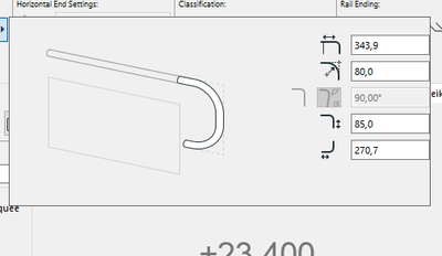

Dear Jeff,
Thank you very much for the report and I am very sorry about the issue!
Without having the file, it's hard for me to tell exactly what might happen, but what you show here looks similar to what Ling pointed out. The defect looks like this:
If the extension is set to anything larger than 0, there will be a mismatch between 2D and 3D. Unfortunately, due to the complexity of the bug, we can only fix it in Update 2 for Archicad 25.
I am very sorry for the trouble that this bug is causing! Please let me know if you have any further questions.
Thank you very much for your understanding!

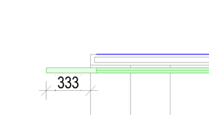

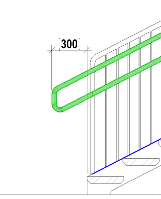

Hiro
Hello.
I have seen a similar problem with Archicad 25 build 4013 INT FULL. I am wondering if this is a bug that has been checked before.
For instace, when the handrail ends at 300mm away from the last step in elevation, the floor plan says 333mm which is wrong.
Seemingly if the full return is chosen for the end and it is placed in slope, the presentation in floor plan goes wrong.

Dear Hiro,
Thank you very much for the report and I am very sorry for the issue!
Based on the screenshots and description, it looks very similar to the defect mentioned above. I could confirm that it still happens in AC25 Update 2, so I opened a case in our support system for further investigation. As soon as I have an answer, I will let you know!
