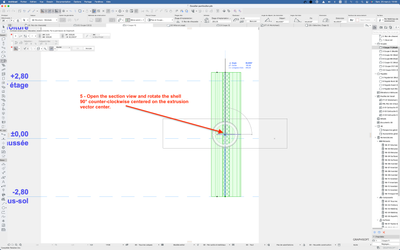

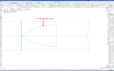

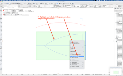

I want to make some curvy shapes on a roof.
Round shapes from above (I've succeeded in that).
But from the side I want to bend the roof so that it bends down in a round shape (I haven't managed to do that myself).
I also want to put the pieces together into one, since there are currently two of them. Does it work?

Yes exactly! That's what I meant from the beginning. "Curved in only one direction"

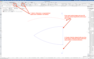

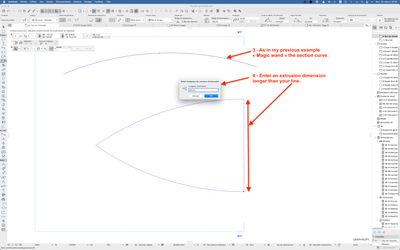

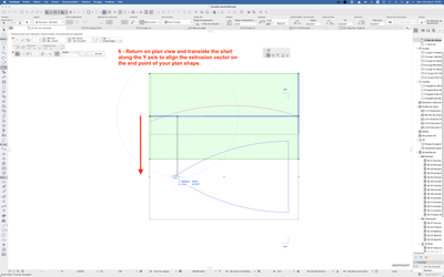

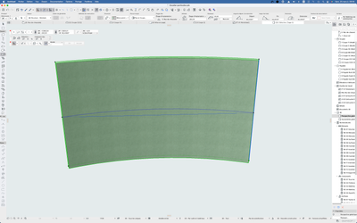

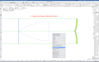

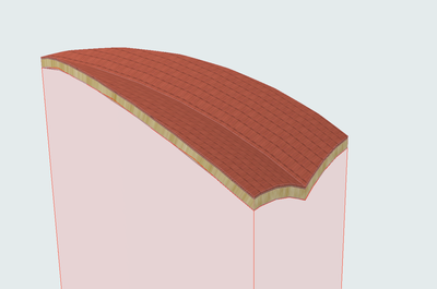

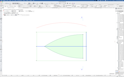

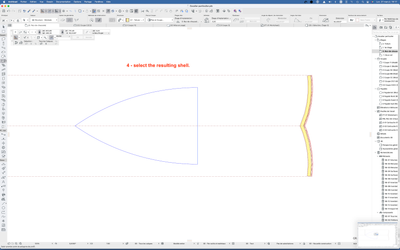

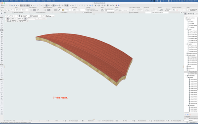

Hi, for that one you need to construct your shell by extrusion.
ArchiCad 3.43 to 28
MacOS Monterey
Then I have finally succeeded in what I wanted from the beginning!

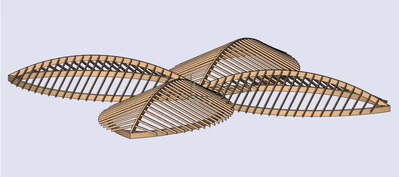

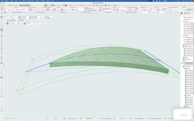

What I didn't tell you at the beginning, and that I "might want to do" is a cut down the middle.
 Something like that ?
ArchiCad 3.43 to 28
MacOS Monterey
ArchiCad 3.43 to 28
