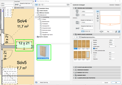

Bibliotek 26 library - Wardrobe can be placed as door element
Not sure is it bug or option. But in AC26 NOR library "Bibliotek 26" door element can be replaced with wardrobe. Wardrobe becomes connected to wall, its nice thing because when I move wall, wardobe placed inside that wall also moves together. Anyone know more about this feature/bug ?

It's a nice option to have a built-in wardrobe object. It's just that, not a bug at all. This gives you an option if you want to make a difference between free standing wardrobe cabinets and built-in wardrobe cabinets. They should be on a different schedule though.

Just means the object is saved with the type set to Door, rather than a generic object. Using this sort of object would probably result in you needing to modify your schedules a bit.

It is a great feature, I am trying to get the doors to pick up the information From Zone and To Zone so that the object doors swing direction can be known. The object is not reading like a door but is reversing the swing direction. Any solutions?

I don't think this will be possible as it is not exactly like a door where you nominate where the door swings to when placing it.
With the robe you nominate where the robe box is positioned and the doors will be in the opposite direction of course.
So that is why they are the opposite of what you expect.
I don't think anything can be done about it other than have the object re-scripted you you place it by nominating the door swing.
