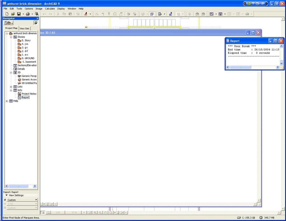

Blank 3D Window and error message. Please help.
I have opened the drawing and when I press 3D window button I get screen number 1. After i click OK i get screen number two.
Anybody know what is going on?
Thanks for your help.

It appears you have a library part or add-on that is looking for a text file. Search your hard drive for the file and make sure it is in your loaded libraries.
Failing that, go to >Options>Preferences>Imaging and Calculation... and make sure that "Interrupt with error messages" is turned off. This might avoid the interrupt (User Break) and at least get you a 3D model to look at.
It is possible that there are some elements you are depending on which need the text file. In this case you will have to find it, or replace those parts.
Thanks for your reply.
The drawing originates from a colleague that saved the project in *.pla and after i opened it (and extracted the library that he had saved with the pla file) i get this error message. I do not understand why, since he attached the library and therefore it should include all relevant information in regard to this project.

The Save as... Project Archive has a critical flaw. I doesn't include macros that are called by use of a variable name. In your case it is also failing to include the text file that the library part is referencing.
One solution is to select "Include all parts of loaded libraries" in the save as options. This can be problematic since the archive file will probably become quite large, and you will begin to create many multiple copies of the libraries.
A better solution for you would be to set up some file synchronizing or backup software to keep the libraries at both locations up to date. It would be best to set this to run automatically at night so it doesn't occur while people are actively using ArchiCAD.
