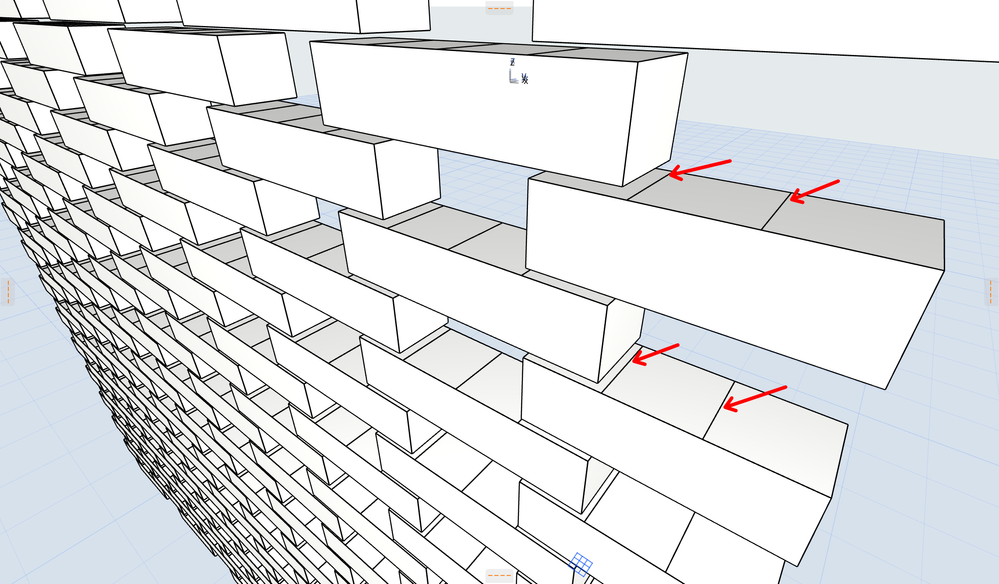

Hi guys, I am using Curtain tool to make a pattern brick wall. But there is some lines in 3D view as shown in the picture. Can I make them invisible? Thanks.Snipaste_2022-03-19_22-26-10.pngSnipaste_2022-03-19_22-25-56.png

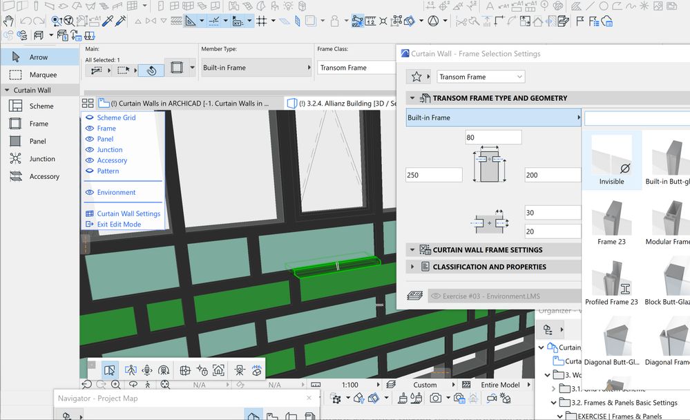

You can make the frames invisible.

William Yan
I have made the frame invisible, but the line still there.
