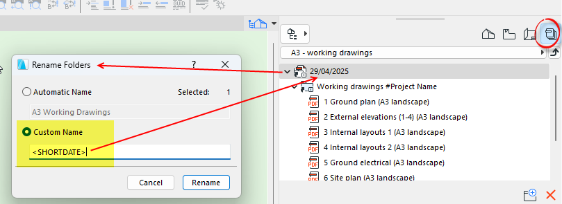

What happens if you manually type the autotext that you want?
i.e. <SHORTDATE>
You can't add autotext from a list, but you can type it.

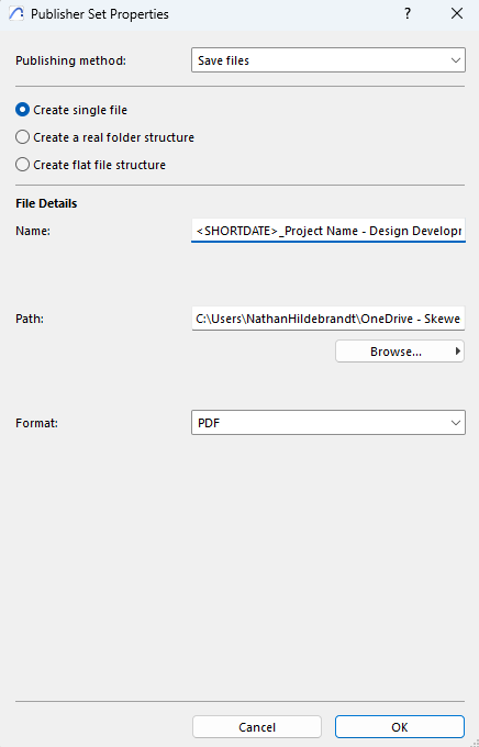

I don't think it is possible. The way I name my single merged PDF files when I publish them is to change the name (date) of the file at the publisher set properties dialogue box. It doesn't solve your problem but you can have the back end of the file named the first time you do it, then just manually change the date before I publish each set.
Regards Nathan

It doesn't work at the file naming level. 😥

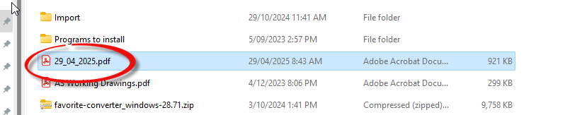

I just tried (version 22).
Seems to work fine.
And the published file ...
Yes at the Rename folder level, not at the Publisher name level.

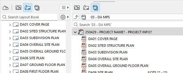

it does if the folder is a shortcut from the layout book. my DA set for example, is as follows:
<YEARSHORT><MONTHNUMBER><DAYOFMONTH> - <PROJECTNAME> - <PROJECT_DESCRIPTION>

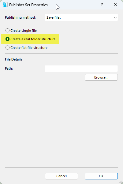

I never save as a single file, always as 'real folder structure'.
Then I don't have to give the file a name, it comes from the publisher folder structure.
