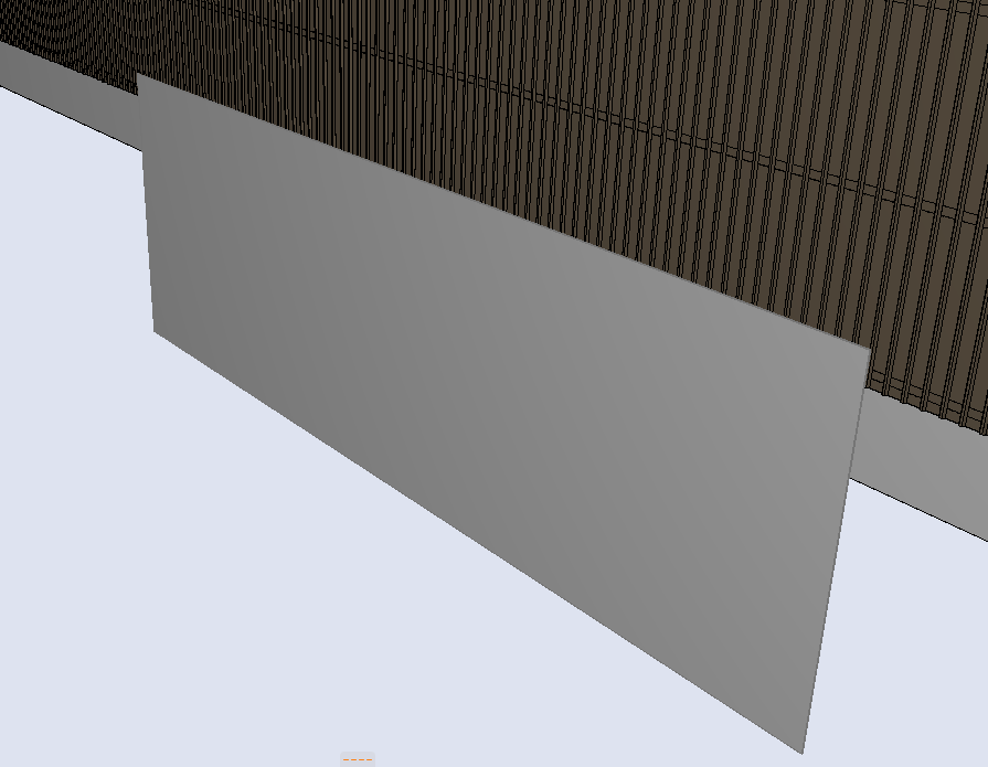

I would like this wall to have a corrugate steel texture that shows up on the surface when I open it in 3D.
How would I do this?
Thanks
4 weeks ago - last edited 4 weeks ago
Apply a Surface Override to the wall, or change the Surface assigned to the selected Building Material.
If you are talking about 3D corrugations, you will need to make it differently, such as using the Profiled Sheet object, using a Wall Accessory for cladding, or using Complex Profiles as a wall, beam or column depending on the orientation required.

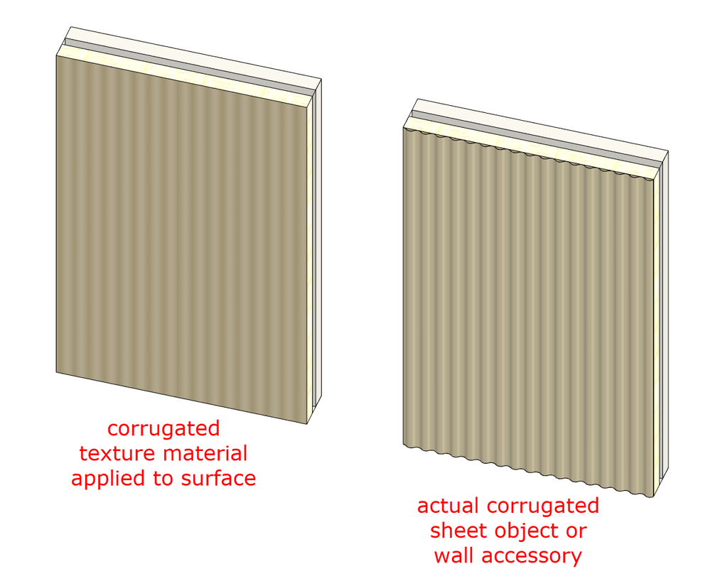

As Ling mentioned, it depends if you want a surface texture that looks like corrugations (flat surface with one polygon), or an actual corrugated surface (many polygons).

Common issue (what your image shows):
Right now your wall is just a flat surface → meaning:

3 weeks ago
As far as I know, the bump map is only visible in rendering not in the 3D view. The 3D views mentioned (Realistic or shaded with textures, aren't the ones usually found in archicad).
The AI reply sounds feasible but it is not applicable here just yet.
3 weeks ago
Correct.
What you will see in Archicad is the left hand image in my post above.
In a 3D render the bump map will come into play.
If you want to see the corrugations in Archicad then you need a 3D object or wall accessory or a complex profile (column).
