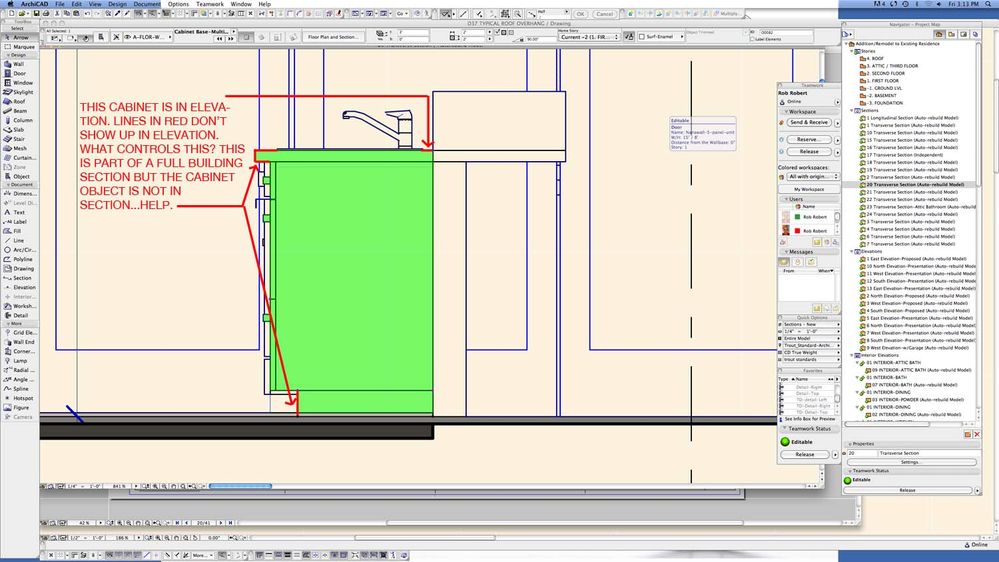

Cabinet object visibility in elevation is not showing up?
rob2218
Section thru building.
interior elevation object (cabinet object) is not in section.
countertop is somehow not "visible" in section/elevation view.
neither is bottom toe kick base plate area (in red).
what gives?

rob2218
here's the section in full.
as you can see...the cabinet countertop portion of the object doesn't
show up in the elevation. Remember cabinet object is "NOT" in section.

rob2218
ISSUE RESOLVED.
see attached JPG explaining what "button" does shut off the "3d edge visibility".
Posting this resolution on the problem I had for all other users who are having the same issue and haven't figured out yet why what causes what....
