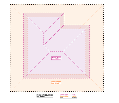

Is there a way to calculate the total area that multiple Elements cover (e.g. Roof objects), while accounting for any overlapping sections?
Referring to the attached example image: An Upper Floor Roof and a Lower Floor Roof, with part of the Upper Roof overlapping the Lower Roof. Adding up the areas of the two Roof objects gives an expected answer. The result I'm interested in is the area bounded by the black dotted line — the total area of the site that is covered by any Roof.
Is there a way to combine the area totals while automatically subtracting the overlapping area?
Alternatively, I would appreciate any workflow suggestions. I'm hoping to avoid creating an additional object, but I can't think of how to achieve that at the moment.

You could SEO holes in a slab using items in a Layer Combo and schedule the top surface area of the Target.  Something like that ?

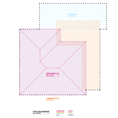

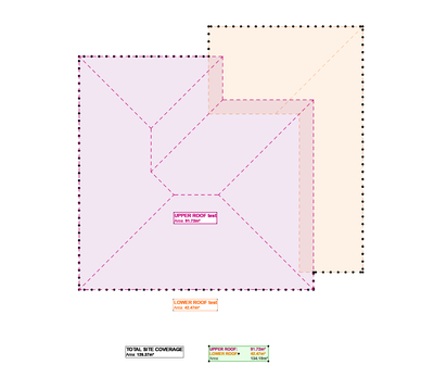

In this case, that could work! I wasn't able to find a Field in my Schedule Scheme Settings that reflects this value. Perhaps you could help me in that regard?
For other cases however, this method may not work:
If possible I would also like to be able to account for overlaps with other impermeable surfaces (tiled patios / paved concrete driveways) that I often model from slabs or meshes:
Let me know your thoughts.

Thanks Barry, yes that's pretty much what I currently do. It's usually fine...
Occasionally I find myself working on a renovation project where I am creating a Fill for the Existing, To Be Demolished, and New impermeable areas for clarity of presentations to local body authorities.
It's not always much extra work — but it can be — if, say:
  • the local body wants to see the various categories of impermeable areas tallied separately (multiplying the number of Fills I need to create)
  • One side of the roof is being demolished
  • Another side of the roof is being extended
  • a third of the driveway is being remodeled
  • this corner of the patio is being extended
  • a week later a change in budget dictates a design revision
  • etc.
In some such cases I've found myself changing dozens of Fill outlines in order to update all the relevant totals that the local body authority likes to see.
The painful part is my awareness that software could be programmed to do it automatically. Maybe it's just one of those things ¯\_(ツ)_/¯
That is actually a very good idea - the areas can all be automated with SEO.
Place a slab the size of your site (site slab) - can be in layer you can hide.
Now you can do Solid Element Operations (subtract with downward extrusion) for all roofs, gutters, paving, etc.
Whatever you are considering for your rainfall collection area.
You can get the areas of this slab, but I can see no way to get the actual 'hole' area without manual calculations.
However add another slab (again in a hidden layer) that is your 'rainfall area slab'.
SEO with downward extrusion the 'site slab' from the 'rainfall slab' and the area of that slab is your rainfall collection area.
So, as long as you keep all of your SEO connections up to date, you know have an automatically updated rainfall connection area.
It is not the ideal solution, but I think it should work.
Similar can be done for site coverage.
