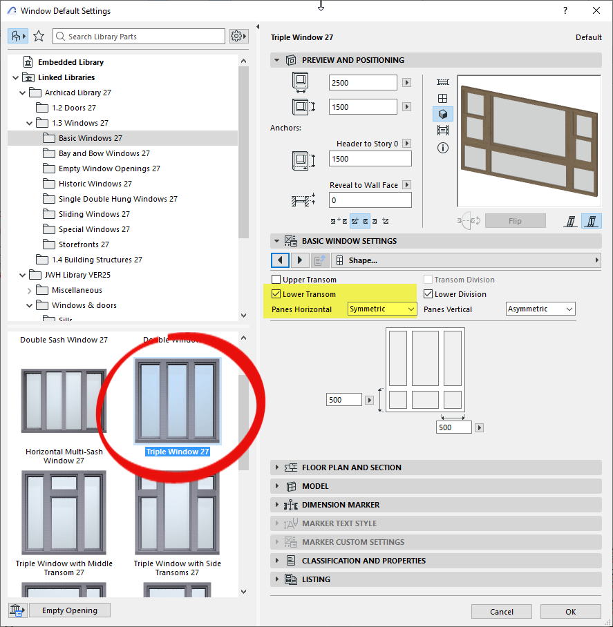

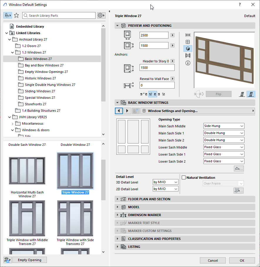

No need to address me personally.
I know I answer a lot of posts, but I am not necessarily the best person to answer. 😮
In this case I am not, as I don't use the default Archicad library, so I am not familiar with the Graphisoft windows.
You seem to be from Australia, so you should have this window in your default Archicad library.
Other nationalities may not have it.
That will give you the basic set-up, but you will have to explore the other settings for frame sizes, etc.
