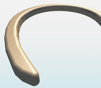

I'm trying to make a handle for a fireplace that resembles the handle on my fireplace at home. I used the polyline tool and filled it with a slab favorite. I've posted the result as an image so you can see. The edges are sharp, but I would like them rounded. Are there a way to do this?

But, you cannot get an arbitrary taper, can you?
Attached is magic wanded spline handle thingy in ArchiForma with rounded top edges (bottom could be rounded too). Jaggy is just the magic wand settings used.
Karl
If the thingie has a planar top and bottom, then I think he could also do it with the slab he had at the start + a half round/ellipse/oval complex profile for the edge going all around, and saving the whole thing as an object.
Also since 11 I think profiled walls can be applied to curved walls, right?, so a curved wall may look better than a polygonal magic wanded wall and exactly match the curved sides in the slab. I don't remember if that is what you get with 'best match'.

Hi Anne,
You could try this variation (created by Daniele Raggi) of the GS slab accessory.
I think it could do the job.
