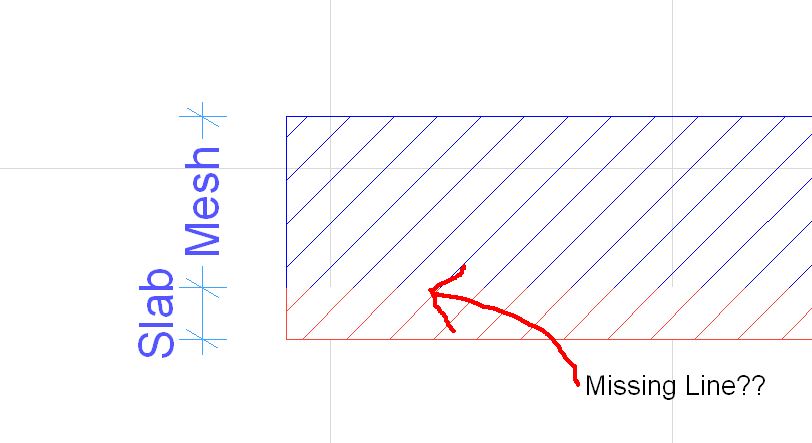

Can't see the contour lines in the middle of two objects
Hi there!
When we draw a slab and put
a mesh in the top of the slab,
and if we use the same hatch
for the section of the two objects,
why can't we see the contour line
that separate the two objects?
thanks for the help
Raul
1 Reply 1
If you have it in different layers, then you set the numbers before layernames to different number.
If you have it in the same layer, then you could make a copy of the fill and use it on the other slab, or set that slab 1 goes from h1->h2 and slab2 goes from h2+0.1->h3.
