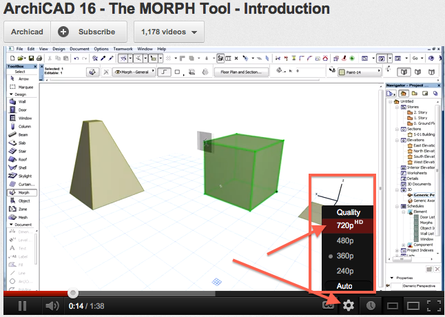

On a side note- the videos are helpful to introduce WHAT can be done, but they move too fast, and are too tiny to be instructional. You can 't really see where they are clicking and what PET palette is popping up. Making the video full screen just makes it blurry.

Re: fuzzy videos - In case you're not aware, you can choose what resolution you want for your Youtube videos (up to the max uploaded by the provider).
For example, the attached shows that the intro Morph video can be viewed in 720 HD - that is just not the default, for speed reasons.
